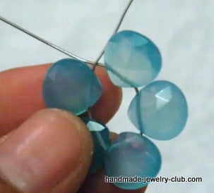

Step 1:
Gather 5 tear drop beads and thread into your wire.

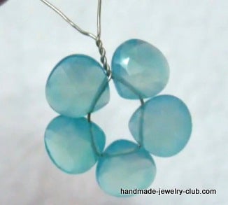

Step 2:
Twist the wire up to 2cm.
Step 3:
Using a nylon string, create a star shape at the center of the tear drops by wrapping the wire onto the wire in between the tear drops.
