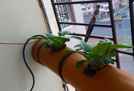

I am going to make a 6 inch PVC Cap from PVC pipe only. For this you need a cutter and adhesive . This bigger size cap cost a lot so i made it from the 6" pipe only but cutting a little bit & used it in Hydroponic project works flawlessly. Its quite easy to make all the items needed are household items. You can also make it for any bigger size pipe cap with this process.

Last portion is now joining the 2 piece. First apply thin layer of PVC cement & fix both circle.Put ressure on it & let it dry for 2 hours. Next apply Araldite to the outer/Inner side of the joint. & leave it for 2 days to dry. Now your PVC pipe cap is ready to use. I used this for Hydroponic project & it works fine no issue.
