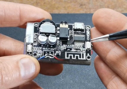

   - a small DFRObot Bluetooth amplifier module model XY-WRBT

  - This small bluetooth amplifier module is actually the main part that wirelessly receives signals from the smartphone software, amplifies that signal, and sends it to the coil that radiates this signal in the form of an electromagnetic field.
 - The module is powered by one lithium or lithium polymer battery, and can be charged with external charger, which is a great option and allows us unlimited inexpensive use of the device. I mention this because commercial devices use a standard, usually 2032 type of lithium battery which, when used up, needs to be replaced with a new one.

 Finally let's see how the device works in real conditions. With a long press on the button, the module is activated and the blue LED starts flashing. Now we need to pair the smartphone with this bluetooth module, while the diode lights up constantly.
That completes the setup. Now we activate the application and select the desired frequency for a specific therapy. We press play, and the therapy begins. Next, this compact device can be placed in a pocket or around the neck with a suitable strap. For protection, I practice putting it in this little anti-static bag. However, I leave it to your imagination to come up with some way to make a miniature, light and strong case.
