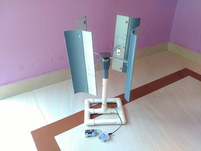

Wind turbines are used to harness wind power. There are different types of wind turbines. They are mainly classified as horizontal axis wind turbines and vertical axis wind turbines.Today we are going to discuss How to Make Vertical Axis Wind Turbine (VAWT).
Step 1:
Step 1

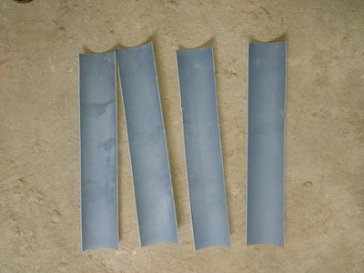

Take PVC Pipe having 4inch diameter and 30 cm length.Axially divide it into 4 equal parts using an angle grinderCarefully use angle grinderMake holes on one side of the PVC using 6mm drill bit
Sep 2
Cut 4 pieces of ACP Sheet having 30 cm in length and 6 cm in widthMark holes on ACP from PVC Pieces and make holes Using 6mm drill bit
