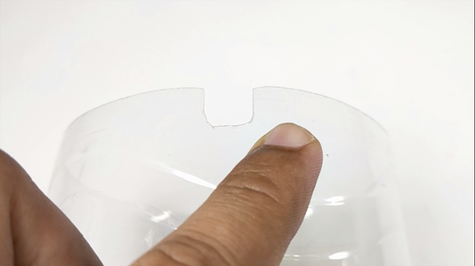

Step 2: Make a Groove at the Bottom of the Bottle As Shown.

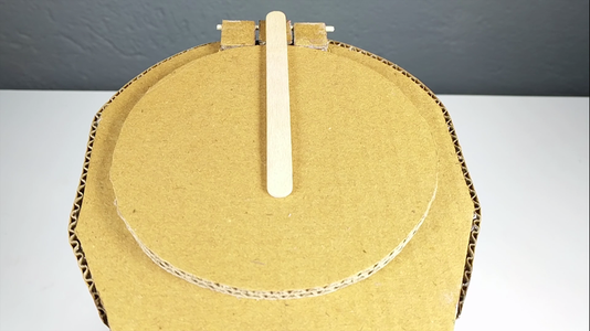

Step 7: Use a Cardboard Piece Measuring 2 Cm More Than the Diameter of the Bottle, to Be Used As the Lid. Using 3 Small Cardboard Cutouts, a Thin Wooden Stick, and Candy Sticks, Make the Lid As Shown in the Following Images.

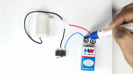

Step 9: Using the Click Switch and Battery, Make the Connections As Shown
