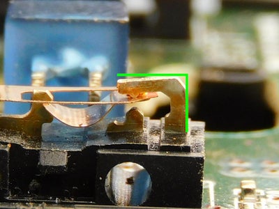

Step 3: Tapping...NOT HAMMERING!
Now once you take off the red cases, you will see an L-shaped protrusion, covering a tiny peice of shaped metal.
As you can see I placed the flat head on the tip of it, and using the handle of my scissors, I GENTLY tapped two times, all you need to do is get it to bend in a bit, just so that it is not exactly flat.
Step 4: Finish?!
Trust me!!! This really works. Now I can edit photos, and draw paths, in a MUCH more focused quiet manner.
Try it, it will save you from having to buy a more expensive silent mouse. Oh! and by the way, this does not mess up click sensitivity AT ALL, it only makes the noise quieter!!!
