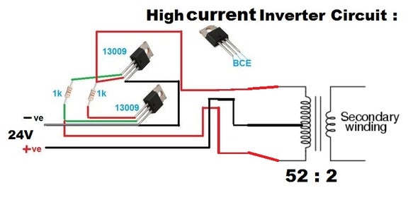

1) The Transformer Center-tap (48-0-48)
2) 2 x Power transistors 13009 NPN
3) 2 x 1 K-ohm resistors 5W
4) Wires normal --> 1amp
5) 50Amp wire --> 0.5 meter
6) 52V DC I/P Source

Step 3: Inverter Construction:
The power transistors used here are 13009.Take the 1 kilo ohm resistors and connect one terminal of the resistor to the base of one power transistor while the other terminal of the resistor to the collector of the other power transistor.
Do the same with the other resistor.Take two similar colored wires and connect them to the collectors of both the power transistors 13009 as shown. Now take the 48-0-48 center-tap transformer and connect the side terminals to the collectors of the power transistor.Now connect the emitter terminals of the power transistor together and connect it to the -24V DC supply and connect that tapping point to the center-tap to +24V DC.
Measure the output voltage at the secondary of the transformer.It should be somewhere between 0.5 to 1 volt AC.

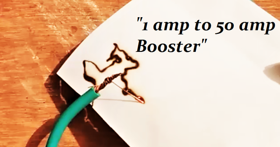

Step 4: Performance Testing:
I conducted several high current discharge tests on the circuit and the results were really good.
It cuts out plastic like it's nothing and also, it gives a really smooth cut results.
What we can do with it :-
  1. it cuts paper with extreme precision as can be seen in the picture.
  2. it can cut wood
  3. it can cut plastics.
  4. it can join plastic.
  5. it can burn matchsticks.
  6. it can be used for making a pyrography tool.
  7. it can also be used for spot welding.
Maximum current output at the secondary should be somewhere around 52 amperes AC at an output voltage of 0.8 volts as in my case.
