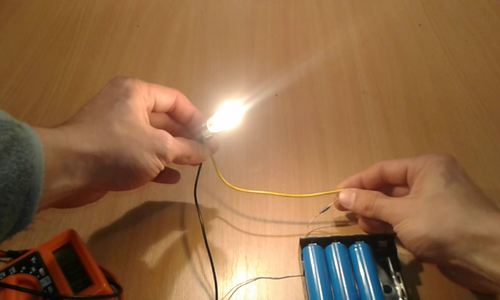

How to make a 12v battery pack at home is an easy project based on multiple Li-ion batteries in series to create a 12v pack.
https://www.youtube.com/watch?v=xddY02m6lMk If you need a 12v battery and want to learn how to make it from 18650 cell watch the video it has details on how to make a new battery at home.You can make this battery from 18650 cell that can be harvested from laptop batteries or power banks, a thing that has Li-ion in it can be reused and reconfigured in a homemade battery
Step 1: Things Needed for the Battery Pack
You have two options one is to solder the batteries and then make your connection series or parallel or mixed
i have found that this 18650 battery holder works just fine and you can reuse them for other projects.
The important steps when making a 12v battery:
Charging the cells
Discharging and see the mAh of each battery
Match them to closed capacity
Make your battery pack by series or parallel connection

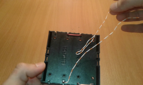

Step 2: How to Make the Battery Pack
In the picture, you can see a very easy diagram on how to solder the wire
keep in mind that the positive + and negative - terminals have to have the same length
to keep the pack balanced that's a tip for future arrangements of combined series and parallel connection

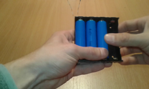

Step 3: Inserting the Cells
Is very easy we will alternate the cells when we gonna put them in the first cell up the plus + terminal
second, up part is gonna be the minus - terminal and the 3rd cell with the plus terminal upwards.
