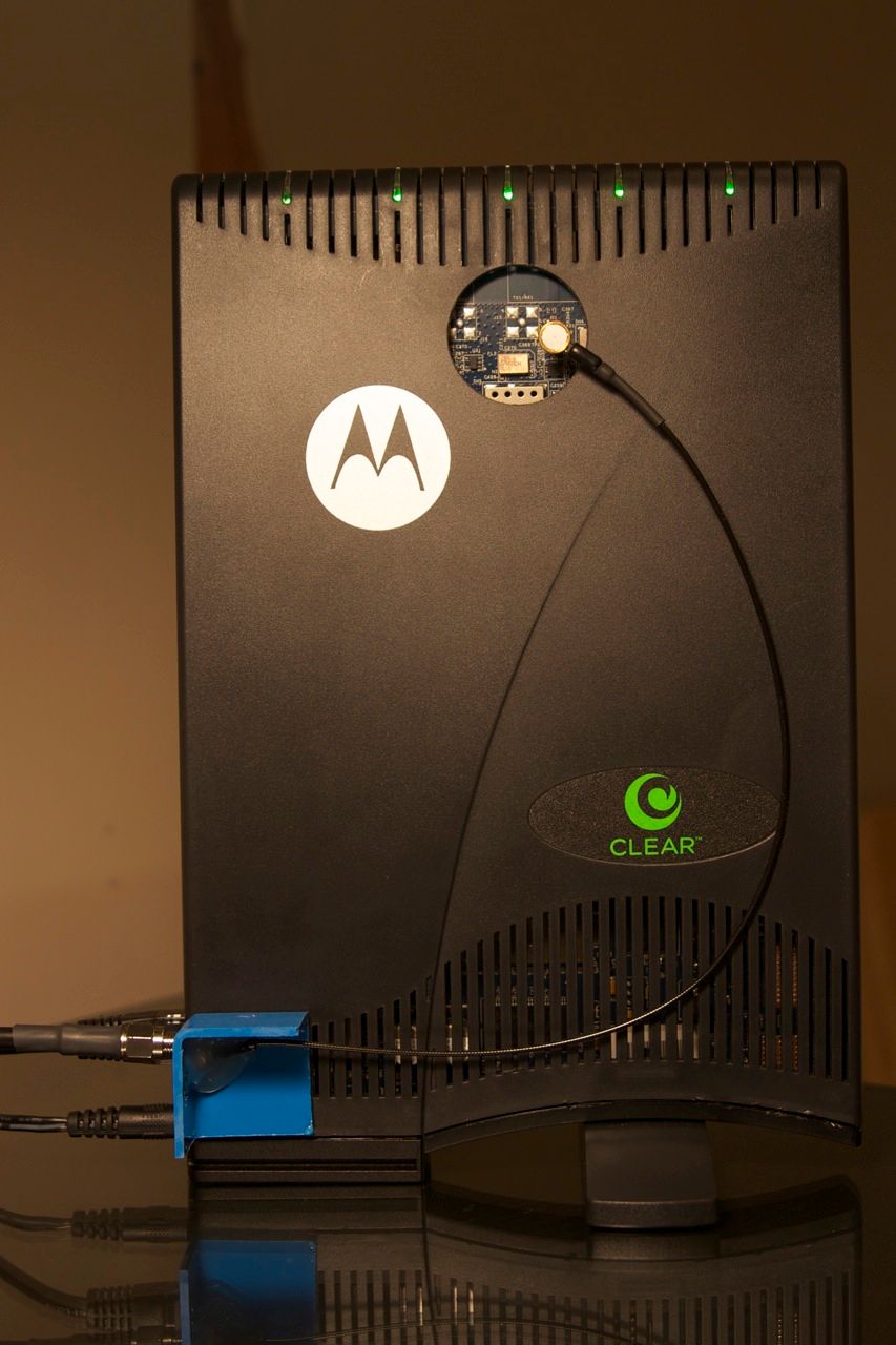

Introduction: How to Make a $19 Police Radio Scanner
In this guide I will explain how to build an inexpensive SDR (software defined radio) that can be used to receive police, fire, taxi, and other digital radio transmissions. I will do my best to explain the steps in detail, and provide further resources to help along the way.
For the radio enthusiasts, this setup is capable of following trunked, digital voice radio transmissions with a single receiver.
Read the full howto here: https://sites.google.com/site/policescannerhowto/
Video of completed setup:
I have to give a lot of credit to the creator of the following guide: http://public-xrp.s3.amazonaws.com/docs/sdrsharptrunk.htm This how to is based largely from that, and other sites listed in the Resources section.
Please use the information in this guide responsibly.
