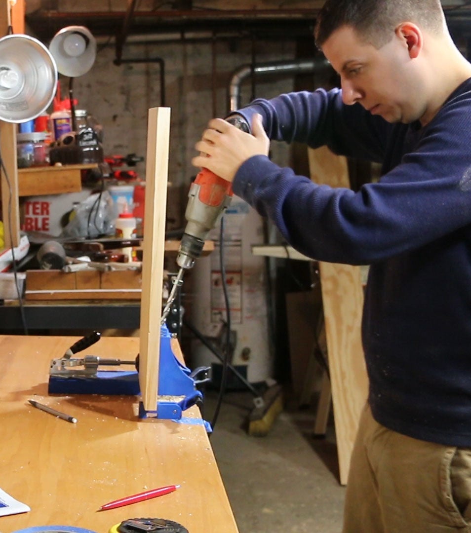

Next, using your Kreg jig, set it for 3/4" stock, which is the thickness of a 1x10. Align the side board so that the marked face is facing you, then drill your pocket holes. Flip the board lengthwise and drill pocket holes on the opposite end of the board and repeat this process for your other side piece.
Once all the pocket holes have been drilled, assemble the frame by screwing a screw into each pocket hole. Make sure that the boards are square and not crooked and push down on the boards so that the screw will bite in. I've found that using a large clamp to push the last two boards into square was very helpful. You can add a small amount of glue to each joint to strengthen the pocket holes, but after I assembled it, it was rock solid.
