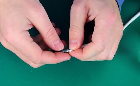

In today’s video I am going to share an interesting idea about how to make a DIY 900°С mini alcohol burner at home!
Step 2: to Make a DIY Mini, Easy to Make and Almost Safe Yet Powerful Burner Is Not Difficult.
A DIY mini alcohol burner made at home suits perfectly for for baking wood, ( giving it flawless texture before varnishing it), and for soldering and desoldering of radio parts or wires.
Step 3: Mini Alcohol Burner Perfectly Performs Its Functions and at the Same Time It’s Very Economical.
Adding a compressed-air bottle or modernising the burner makes no sense. The burner is a small and compact item.

    I think your intro says it all....."Almost safe". There is no such thing as, ALMOST SAFE !. Fire and PLASTIC containers do NOT mix, under any circumstance.
    The issue of blowback is a real concern, and your responce of, "you should be fine" is right up there with "almost safe".
    And if you sayyyyy, DROP IT ? It is NOT a tight seal container. Or if something hot even touches it ? A little common sense goes a long way. So does, "almost safe", all the way to the hospital !

    For about 15 years of my life, I repaired at least 100 large modem or computer boards to component level every day of the week and always used a 800 degree tip on my solder iron. I was replacing 8 pin to 100 pin LSI The idea was to get in and out fast so the heat had no time to spread into sensitive components. It worked very well as I'm sure this will. As far as it getting to 900 degrees, I used to use alcohol burners while in grade school to melt glass. It will be hot enough. As far as the alcohol harming electrical components, I usually used alcohol to clean the boards and components after I made a repair so you could hardly tell a repair had been made to the board. If not alcohol, then acetone or liquid freon although the freon is much harder to get these days and acetone is just nasty. I like this thing but I'm not so sure it wouldn't blow up if you sucked too much flame and oxygen back into your bottle. Flame alone would probably not explode in the bottle without some kind of oxygen in there. This is really a good soldering tool if it is safe but I can't speak for it's safety record. Thanks for the idea. Hope nobody gets hurt...

    It can indeed reach 900 degrees... Tested it... But I partly agree with you because I had to make adjustments... and yes, modernize it as the instructable told us not to...

    On top of safety concerns I do not recommend to use electronic components that have been desoldered at such high temperature.
    Electronic component have to be used within the specification limits, the temperature reached during soldering and desoldering operations are in the datasheet. My suggestion is never exceed 240/250dC.
    Tin melt at ~220dC, there is no real need to go over such temperature.

    Sorry to say, but I've seen a bottle like this exploding while there was less than half alchol inside. You can immagine the scary. A friend was very lucky to have not reporter any burn on his skin.
