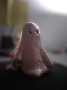

Step 2: Prepare the Ghost Cast
In this step, we will prepare a surface that will allow us to keep the figure of the ghost until it can dry and that can be put in the oven if we want the figure to dry that way. We will have the following materials:
  • Aluminum foil
  • Tape measure, ruler.
  1. We will take a piece of aluminum foil and crumple it to give it an elongated shape. About 8 cm high and 4 cm in diameter at the base.
  2. The upper part of this paper, we will reduce it to about 1 cm less than the diameter of the base, and we will round it with our hands to make the head of the ghost.
Step 3: Making the Ghost With the Homemade Air-drying Clay
In this step we will mold the figure of our ghost with tools and the clay we made in step 1. We will need:
  • Air-drying clay from step 1
  • Sculpting tools or some tool to give shape
  • Rolling pin
  • Scrapper or scissors
  • Straw
  • Wax paper
  • Shape made in step 2
  1. We will take a portion (in my case I took 185 gr) of homemade clay made in step 1 and we will flatten it with the help of a rolling pin, on a flat and clean surface, where we will place wax paper and on this we will put the clay. We will flatten to an approximate thickness of 5 mm.
  2. Once we have the clay stretched in the form of a sheet of approximately 5 mm thick, we cut the sides to make a square, it does not have to be a perfect square.
  3. Remove from the waxed paper surface and place this sheet on top of the figure made in step 2.
  4. With our hands we place the sheet around this figure, and with the help of shaping tools, we will define the base as if it were a ghost with a sheet.
  5. With the straw, we use the tip to mark the eyes of the ghost. The hole in the straw I used is 5 mm in diameter, this will remove the clay and the remaining holes we have left, we can put lights or LEDs in them.
  6. Let air dry or put in an oven at a temperature of about 250 degrees Fahrenheit for 10-30 min.
Note:
Let the figure rest inside the oven turned off for 30 min or until it cools down.
Step 4: Paint and Lacquer the Ghost
In this step we will give the final details to the little ghost. The materials to be used are:
  • Pliers
  • Sandpaper (if necessary)
  • White acrylic paint
  • Black acrylic paint
  • Brushes
  • UV resin, Spray setting, Water based varnish
  • UV lamp
  • Optional (if resin is to be used, to clean the brush): Acetone and cotton swab
  1. We remove the base made with aluminum foil with the help of a pair of pliers.
  2. We can sand the figure a little to give it uniformity, but if you want a more rustic style, it is fine.
  3. We paint with the white acrylic paint on the surface of the ghost, evenly. Let it dry.
  4. After the white paint dries, we paint with the black paint on the inside of the ghost, without leaving any unpainted space.
  5. We wait that the applied paint dries and finally, we will give it water varnish, resin, sealant spray, etc. Uniformly, covering the entire surface of the ghost.
  6. Let it cure for several minutes.
Note:
When using resin, for this project using a brush, a cotton swab and acetone can be used to remove the resin from the brush.

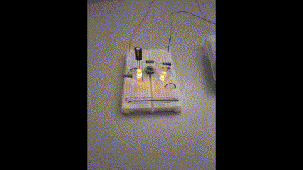

Step 5: Making the Blinking Circuit
In this step, we will show the circuit assembly that allows the leds to be flickering. We will need the following:
  • Breadboard
  • NE555
  • 4 resistors 1k ohm
  • 2 yellow led diodes
  • 1 10nF capacitor
  • 1 100uF capacitor
  • 16 AWG wire
  • Circuit of lights that have battery holder (to use the battery holder)
Let's start by looking at the data sheet of the NE555 integrated circuit, since it will be the basis of the circuit.
We determine the pins and connect the components as follows:
  1. Connect pin 1 to ground. Fig. 1.
  2. Connect pin 4 and pin 8 to positive voltage. Fig. 2.
  3. Connect from pin 5 to ground, a 10nF capacitor. Fig. 3.
  4. Connect by means of a cable, pin 6 with pin 2. Fig. 4.
  5. Connect an electrolytic capacitor of 100uF, from pin 1 to pin 2; placing the negative polarity of the electrolytic capacitor in pin 1, and the positive polarity in pin 2. Fig. 5.
  6. Connect a 1k ohm resistor from pin 2 to pin 7. Fig. 6.
  7. Connect a 1k ohm resistor from pin 7 to the positive voltage. Fig. 7.
  8. Connect from pin 3 (the output pin of the 555 timer) a wire; from this wire we will connect a 1k ohm resistor and from that resistor we will connect to the anode of a led diode, and this led we finish by connecting it to ground. Fig. 8.
  9. Then, from this same cable that comes out of pin 3, we will connect the cathode of another led diode and from the anode of this led diode, we connect a 1k ohm resistor that will be connected to the positive of the battery. Fig. 9.
  10. From the positive and negative of the breadboard we will connect the battery that in this case I used a battery holder of decoration lights (the lights can serve for another project), since this one brings its switch.
We test the circuit with a voltage between 3 Volt to 5 Volt.
Once we have verified that it works, we can solder the circuit on a board.

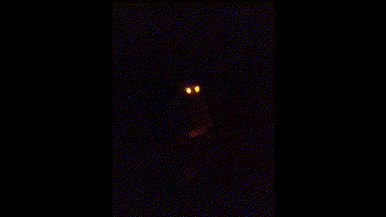

Step 7: Assemble Circuit and Ghost Figure
In this step, we will assemble the circuit to the ghost; for this we will need:
  • Ghost already painted and lacquered.
  • Circuit with battery holder from step 5 and 6
  • Silicon glue
Glue the LEDs to the ghost's eyes.
