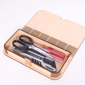

Step 6: Assemble the Kit
When the cutting is done, remove all pieces carefully and start assembling. Each part should fit snugly into its slot — no glue needed! The interlocking design ensures a solid and durable build.
put the pieces together to make a perfect kit
Step 7: Complete the Task
Once assembled, the tool kit is ready to use. You can put all of your tools inside it to make your workshop clean and tidy!
put your tools inside the tool kit
