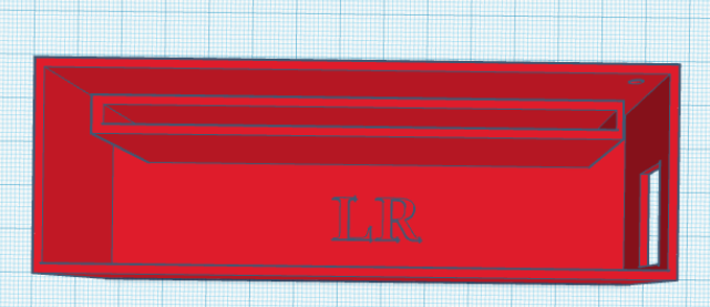

Step 3: Designing and Printing the Box

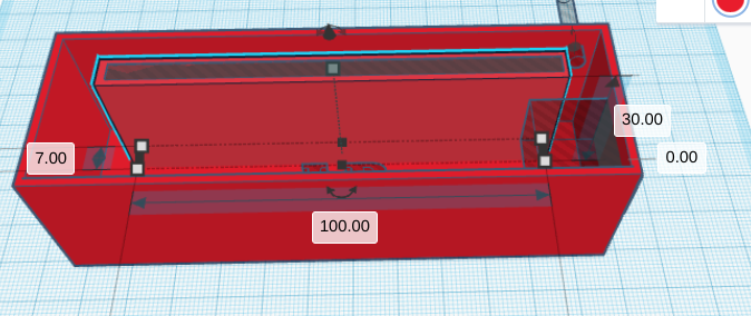

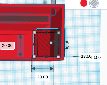

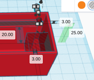

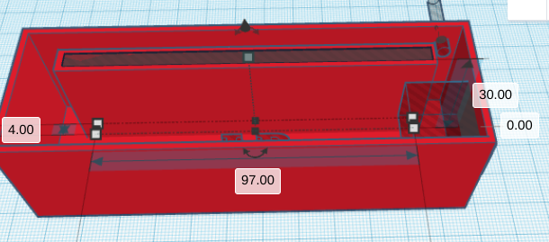

When printing your 3D- box it's always best to double-check your dimensions and prototype your lid and box just to know that your dimensions are correct. When putting dimensions we interpret the parts that will go in the middle of our box, light switch, led's, a wall for acrylic design to stand upright.
Light-box

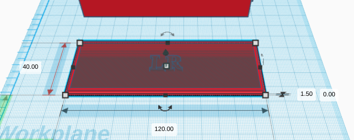

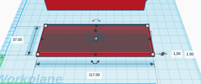

When making the cut for the acrylic design the outer wall will be 100 mm long and the inside cut will be 97 to have 1.5 mm walls.

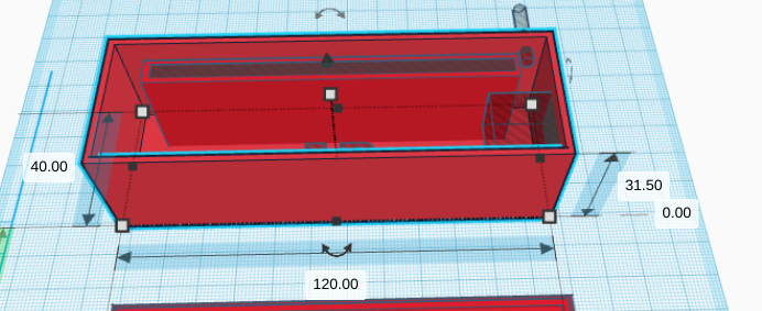

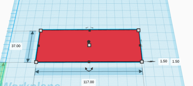

LID for box
For the lid you should create a flat box like in the photo with those dimensions (120, 117, 40, 37). Then get another flat box with 3 less of each dimension and place over the first flat box using alignment tool . I choose to add my initials your preference.
