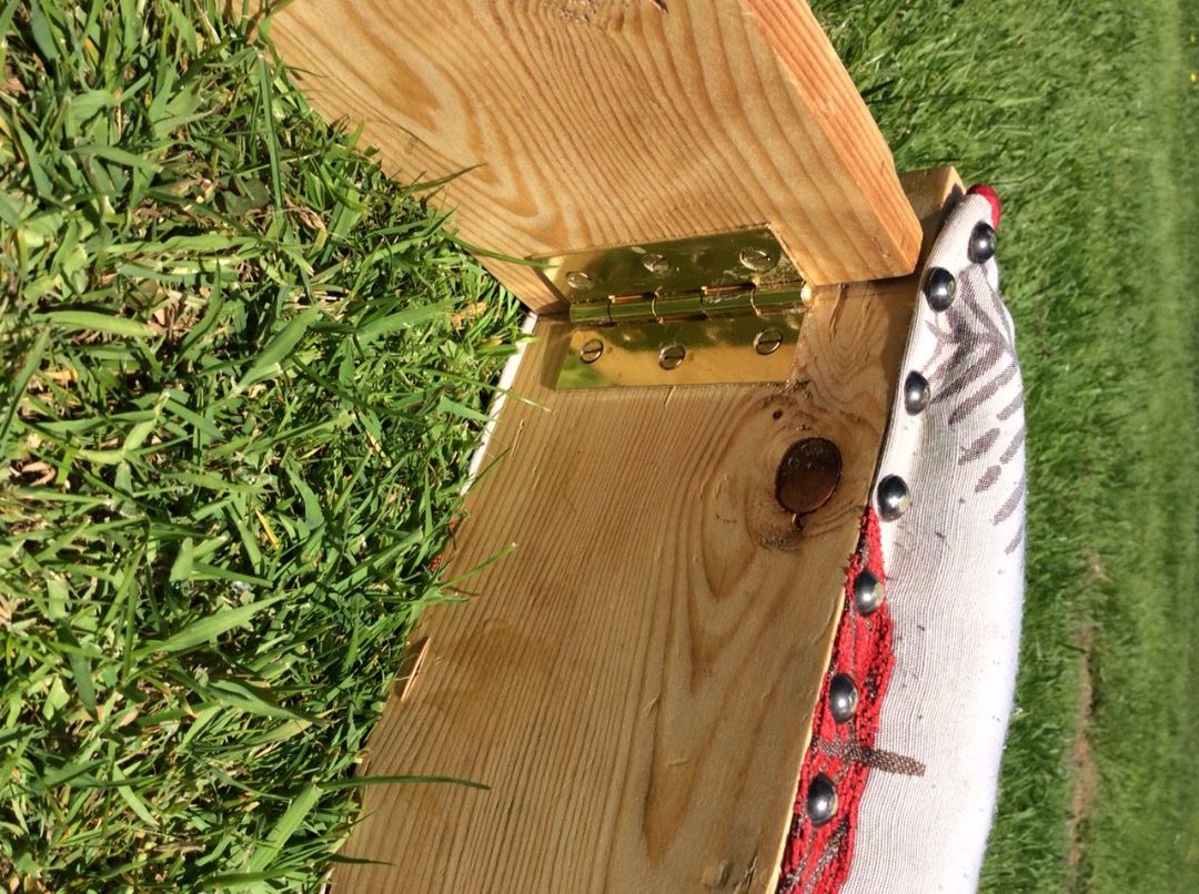

Hello. A lovely project for my ageing knees. Thank you.
I added a couple of innovations:
1) Hinges. Makes it much more portable / storable. With 75mm door hinges, there is very little play and they are sturdy enough to carry my 80kg without wobbling.
2) Cushion: I took a standard 12" hollow-fibre cushion. Cut the filling in half and used this to create the padded area. I used the cushion cover itself to create the fabric covering. Doing it this way gave me a high quality finish to the edges without doing any sewing. The whole thing took me 30 minutes. I didn't need the staple-gun suggested earlier, but it could have have made the upholstering slightly easier. Probably went a bit nuts on the fabric pins.
Regarding the height, my legs were just over 6" finished height, and I'm 6' - which works well for me.
Wishing you all much happiness in your practice.

Reply 8 months ago
Would you please tell me, does the contact point between the legs and bench need to be angled to be sure the hinges stay locked open?
