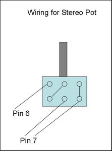

About the potentiometer: If you click on the link, it won't take you to a 250K ohm potentiometer. That's because Radioshack doesn't have one. Instead, I found a stereo 100K pot at Radioshack and the two signal paths in sequence so it became a 200K pot (which is close enough). The diagram for this is in the next step.

Basically, just follow the picture below to put the circuit into your breadboard and wire it up! You can add in the switch at the +9v input or at the ground output. I used ground. Make sure to get the polarities on the capacitors and on the LEDs right! If it doesn't work, double check your connections and then make sure that the LEDs and the pot and all of the parts work. If you turn it on and it doesn't work, turn it off and make sure that no parts are hot. If any are, you may have fried them with a short or by putting them in backwards. If you are using the stereo pot, check out the wiring diagram for that below.

I need a more simple diagram, I tried using this diagram & nothing happened. Except for one of the LEDs burning out & no sound on the speaker. I know nothing about reading circuit diagrams & even lesser about the parts, what to use & what side to connect, positive, negative ex.
Can you explain the wiring for 3 pin potentiometer and how it is connected with the resistor above it (as in circuit diagram)?

Ey can the potentiometar have 3 ends not 6? i mean will it work?
0
bananafred
bananafred
Reply 11 years ago on Step 2
 Yeah it will work fine as long is it is the right resistance.
