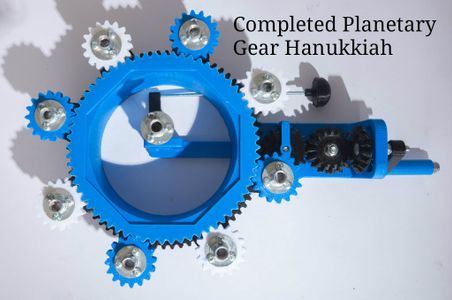

First off, I'll acknowledge that this is technically a "hanukkiah", however, I figured that due to the common misconception of associating a menorah with Hanukkah, more people would understand what the project was about so I decided to go with that name instead. With that out of the way, this is one of my favorite creations and I'm very excited to share it. I have not seen any hanukkiah that has any moving parts like this one, so I believe that is the first of its kind.
I won't go too in depth in to Jewish tradition (after all, this is an engineering tutorial) so here's the wikipedia page on Hanukkah if you wish to learn more: https://en.wikipedia.org/wiki/Hanukkah Instead of a traditional hanukkiah, where you light each of the candles with a shamash (often the center candle), my hanukkiah uses gears to rotate the individual candles around the shamash. The shamash can than tilt down to light each of the candles. Admittedly, I am not the most involved with Jewish customs, so please let me know if there is some cool spiritual significance that this hanukkiah adds where others don't or if it is somehow offensive (hopefully not!)
As for the usability, despite being made out of plastic and basically being a fire holder, I have not run into trouble with the plastic melting. The candles are held by 3/8" T-nuts with a bolt beneath them, and those seem to contain the molten wax well enough that the plastic remains unharmed. The only problem I've had is occasionally the shamash will drip over the plastic when its tilted, but the wax has never had any issues when coming off. Also if you can't get the wax out of the T-Nuts, you can always just unscrew them and clean them out from the other side.

Assemble each of the 8 candle holding gears (planets) as shown in the picture. or with the following instructions:
  • Place all of the 608 bearings into the carrier.
  • Tap the 3 holes in each of the planets with a 6-32 tap.
  • Place the M8 x 30mm bolt through the gear so that the cap is embedded in the gear and the shaft sticks out the other end.
  • Screw and tighten a M8 nut onto the end of the M8 bolt.
  • Put an M8 washer on the bolt.
  • Place the assembly on the carrier.
  • Fasten assembly with a M8 Nylon lock nut. Tighten it, but not too tight that there is resistance. I found a good tension to be when the planet cannot move significantly move up and down, but still has room to wobble back and forth a little bit.
  • Attach the 3/8 T-Nut onto the top with 3 6-32 x 3/8" screws.
  • Repeat for the remaining planets.

Follow the pictures and/or these instructions to finish the hanukkiah:
  • Place the carrier on the sun base and then place the sun top on top. The planets will probably need to be moved around slightly so that the sun top will go down all the way.
  • Slide the crank assembly into the side of the sun base. You will probably have to place the sun base over the center candle holder before sliding it in the rest of the way.
    • Tap the 4 screw holes with an M3 tap and then put the M3 x 16mm counter sunk screws into holes.
  • The all thread will act as a handle for the center candle, so cut your all thread to a length of about 15 cm / 6 in to span from the tilt bracket to outside the hanukkiah.
  • Tap the tilt handle and tighten it onto the end of the all thread.
  • Put the all thread through the hole in the sun base and tighten it in the tilt bracket.
You may also want to add some rubber feet to the bottom so you can spin it without the whole thing sliding, however I did not.
That's all there is! Now you should have your very own planetary gear hanukkiah!
