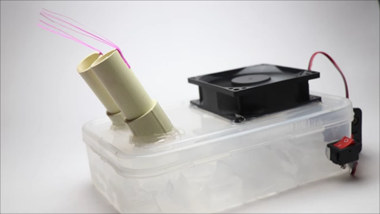

CPU fan is a well-known device that is used to keep our CPU cool by removing the heat from the processor.
We are using this fan in our project to supply/pump air into the container.
Via CPU fan air enters the container filled with ice and the end result is cooling the air.
As we have provided a dedicated slot for air exit on the container from the other end air exits carrying the cold air.

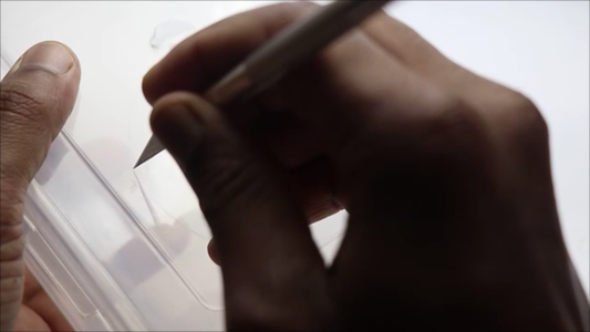

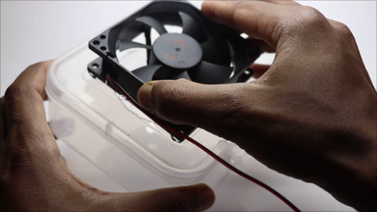

We will add a CPU fan to the container/Box.

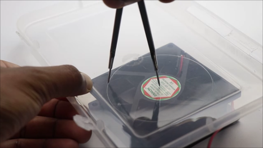

To do this we have to first mark the area where the PC fan will be installed, Open the lid of the container, and keep the CPU fan on top of the Lid, Now from the bottom part of Lid you can trace the shape/dimensions of the CPU fan
I used a compass made from metal to mark, you can also use markers if you don't have a compass.
Once you outline the shape, Cut the extras using a cutter, if your plastic is kind of brittle and does not cut properly you can try heating the cutter a bit and continue to cut.
End of this process you will have a slot as you can see from the last image on this step.

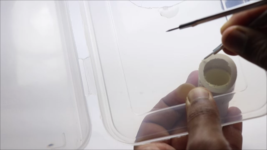

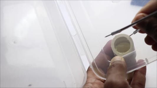

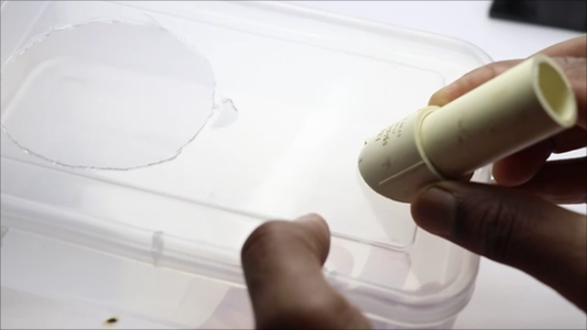

Step 2: Making Slot for Air Flow
As we did in the previous step we need to follow the same steps here to make space for the airflow.
Mark the PVC tube dimensions on the lid of the plastic container, Since we are using 2 PVC tubes make 2 slots.
After the marking is complete cut the marked areas with a cutter.
Here one thing you need to make a note of is not apply great force while cutting, We already have holes in the box lid part that contributes to the overall strength of the lid, Forcing too much may lead to cracks on the lid.
Don't be soo size specific, small under/over cut when compared to marked areas would do as we will be sealing this in utter steps to prevent any air leakage.

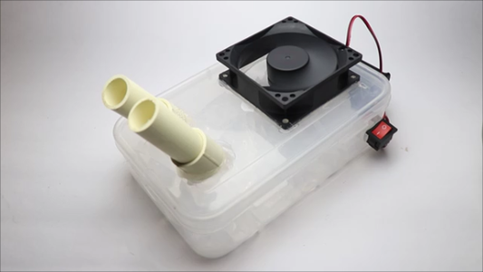

Step 3: Installing Fans and Tubes

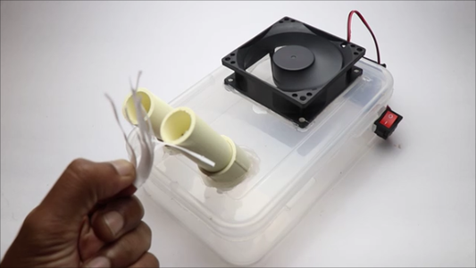

After we have made the slots ready it will take only a few simple steps to get these components together.

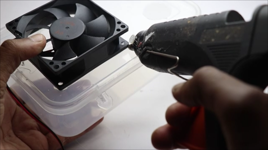

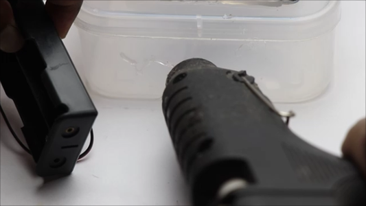

Note: Do not heat the hot glue gun too much, Using too much high-temperature glue might disfigure the container/plastic box as we know plastic melts when provided with too much heat.

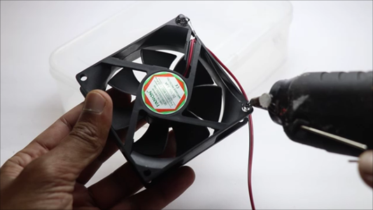

We will start by adding a few drops of hot glue to the edges of the PC fan Body, Add glue to all 4 corners and place it on top of the slot
Now to make this air sealed add hot glue to all the sides of the PC Fan Body.

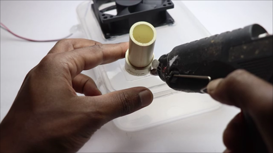

After this is done we will repeat the same steps for the PVC tubes also, Even here you have to make the space between PVC tubes and the container air sealed.

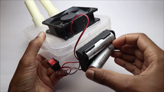

Step 4: Installing Electronics

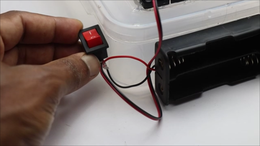

Follow this very simple circuit diagram to power the CPU fan.
Let me explain the circuit diagram very quickly.

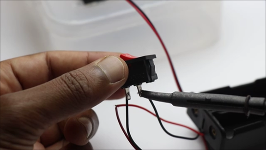

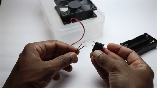

  1. DC fan/CPU fan has 2 terminals, red and black
  2. red is a positive power supply from the dc source and black is for negative power supply.

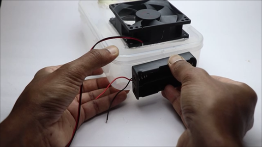

  3. The positive terminal/ Red wire of the PC fan is directly connected to the positive side of the battery supply
  4. Now we will add a switch between the negative terminal of the CPU fan and the battery holder
To place the battery holder refer to the images above and use some hot glue to keep everything in place

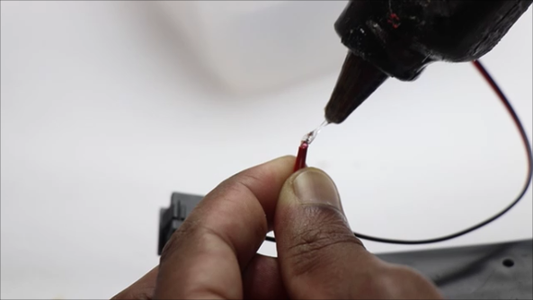

Did You know?
Wire connections can be insulated using hot glue. Yes, you can see it as i have done in this project, refer last image of this step.

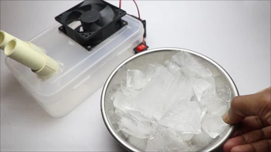

  • Insert the batteries into the battery holder
  • Switch on the power button, DC fan will start spinning
  • Check the airflow by placing the bare hand in front of PVC tubes, you feel the air flowing

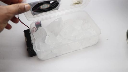

  • Now off the switch and add some ice to the container
  • Close the lid and switch on power button
  • You can feel the cold air instantly, to show the air flow i have added red color ribbons in front of PVC tubes
