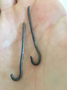

  2. I cut two pieces of wire and bent them into a hook shape. (These will support a horns, and make sure they don't brake.) If I were to do this again I would twist a second piece of wire around the first, and bend it so that it would support the second, smaller part of the horn because that part kept braking off.

  4. Sculpt the horns, and then take the face off of the armature and bake it.
