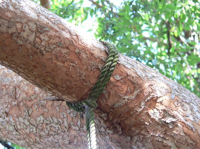

When you have found a suitable tree, get your rope and your heavy object. Tie the end of the rope to the object and throw it up over your chosen branch/support. Take the other end of the rope and tie a strong loop. Untie the object from the rope and feed the end of it through the loop and pull. The end with the loop should get pulled up to the branch/support and form a strong fastening. You could also double up the rope instead of tying a loop, as shown in the picture, but you end up with two ends of rope.
