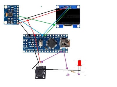

Step 2: Schematic
Make the connections of the components according to the diagram below
