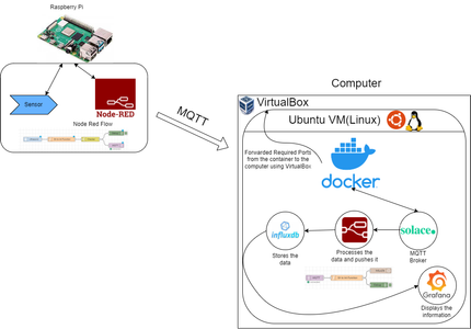

I wanted to detect if somebody walks into my room, so I set up some sensors and connected them to my computer. I quickly realized, however, that I didn’t want to always have my computer physically connected to the sensors because I’d no longer be able to use the computer throughout the house. I also realized connecting the sensors to my computer would mean I couldn’t easily add sensors in other rooms if I wanted to. So, I decided to publish data readings from the sensors to my computer using a messaging protocol, and I settled on MQTT. To do that, I’m using Solace PubSub+.
In this article, I’ll explain how I set up a Raspberry Pi collect sensor data and send it to my computer using MQTT. The point of running it on the computer is to have expandability with more things sending information, for example adding more Raspberry Pi’s over a certain area with more sensors attached to them.
I did this by setting up a Solace event broker in a Docker container on my computer and making it responsible for receiving data from the Pi via MQTT. I used Node-Red on the computer to decide what to do with it – for example I made it store sensor reading in a database and graph it with Grafana.

The first challenge I faced was that my docker ports weren’t being exposed over my network, so the Pi was not able to communicate with the Solace broker running in the docker container. After doing some research, I found that trying to expose the ports on the host OS using something called "MacVLAN" might break something in the IP networking and learned that putting in place a virtual machine and exposing it from the VirtualBox manager might do the job. So, I installed VirtualBox, configured the Docker images on it, and it started working as expected.
For the guest operating system, I recommend a Linux based OS – I am using Ubuntu, myself. After you have the image for whatever OS you're going to install, create the VM and go through the installation process. To expose the ports, open the VirtualBox application, click your VM and press settings in its menu bar. Head over to the Network tab, click Advanced, and click Port Forwarding. The specific ports for the Solace broker are available here.

Node-Red: docker run -it -p 1880:1880 -v node_red_data:/data --name nodered nodered/node-red Solace: docker run -d -p 8080:8080 -p 55555:55555 -p 8008:8008 -p 1883:1883 -p 8000:8000 -p 5672:5672 -p 9000:9000 -p 2222:2222 --shm-size=2g --env username_admin_globalaccesslevel=admin --env username_admin_password=admin --name=solace solace/solace-pubsub-standard

The Pi will read the data from the sensors and send it to the Solace broker. Before you start doing anything, make a note of your computer and Pi’s IP addresses, as you'll need them to communicate to the Solace broker and Node-Red. Once you’ve done that, make sure that Node-Red is running on the Pi and Solace in your VM.
Connect to the Node-Red interface by entering
:1880 in your web browser. Once it's open, drag out a node that you want to send the data with, like an inject node for testing or a sensor one. Then drag an MQTT out node and connect your previous node to it. Double click on the MQTT out node and click the pen icon to configure it. For the server, add your computer’s IP, the MQTT port is already filled out as 1883. Click save and add a topic like "test/sensor". Deploy it, check if it's connected, and you've got your connection!

Now that you've got connection, you can make it use that information on your computer using Node-Red by using an MQTT in node, and you can install InfluxDB and Grafana in the VM to make Node-Red connect to InfluxDB and graph it onto Grafana. You can even go as far as forwarding the ports on your router to access the data over the internet. From there, if you decide to do this as more than a learning exercise, you’ll probably want to stream data to the cloud for more security, flexibility, and reliability.
