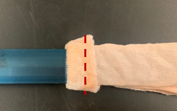

  4. Insert the spring sheet metal inside of the inverted tube of fabric made in Step 4. Place the elastic circle around the inverted tube. Inserting the metal inside of the fabric tube stretches the elastic and makes sewing in the next step easier.
  5. Fold over the top of the fabric tube to cover the elastic. Leave enough room for a seam allowance.
  6. Sew a basic straight stitch around the tube to create tubing for the elastic.
