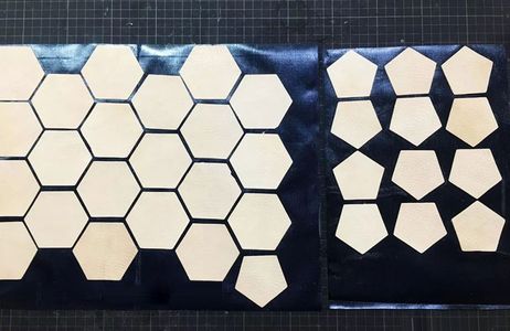

Step 1: Step 1: Cut All Leather Pieces From Acrylic Pattern
Step 2: Glue Cloth Lining on Flesh Side.
Step 3: Cut Each Pieces Off With Lining.
Step 4: Draw Stitching Lines and Cut the Small Corners.

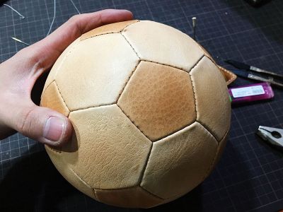

Step 7: Sew 5 Pieces Together With Small Piece in the Middle, Go Ahead.
Step 8: Turn Grain Side Out and Put Bladder In, Insert Ball Needle In, Then When You Deal With the Ball, the Bladder Won't Drop In.
Step 9: Here We Use a Special Sewing Skill Named "drawing Stitch", It Comes From Cloth Sewing Skill. by Using This Skill, You Can Hide Thread in the Ball, It Is Very Hard to Explain, So Please Look at the Pictures Carefully.

    Question 2 years ago on Step 1
    How many pieces of each size?
    0
    LZpattern
    LZpattern
    Answer 2 years ago
    Small pieces x12
    Large pieces x20

    bakichmg
    bakichmg
    2 years ago
    Hello, the ball looks real nice. Would you please post where you got the parts to make it please. The leather, thread, needle. Please explain how you did this, how you cut the leather. I am really interested in how to make this. Please write up an instructable. Thanks in advance.

    LZpattern
    LZpattern
    Reply 2 years ago
    The soccor making instruction updated.
