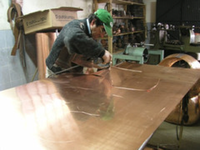

Step 1: ​1- Cutting
The sections that will make up the different parts of the still are carefully marked and cut out using electrical or hand shears. These cut out sections are stacked aside before passing on to the next phase.

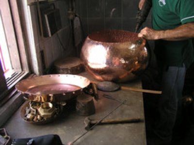

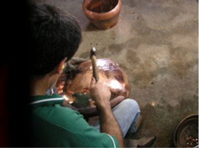

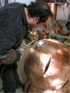

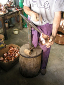

Step 2: 2- Shaping

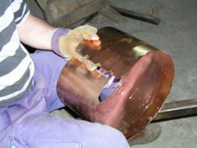

In this phase of the process the different parts begin to form recognisable shapes. Each dimple is skilfully hammered by hand as it has always been done by our artisans and their fathers before them, in a vigorous and strenuous effort to beat the copper into the desired shape. The single long sheet that will make up the belly of the pot is joined by interlocking or dovetailing the ends together before being welded and beaten on a concave stump to give it its’ rounded shape.

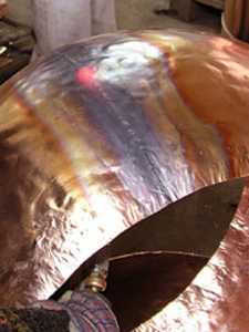

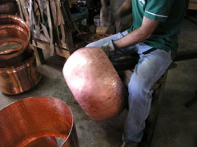

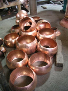

Step 3: ​3- Welding the Belly
The part that will make up the belly or sidewall is joined by welding the dovetailed ends together. This is done by oxyacetylene gas welding which makes the copper soft and malleable. The join is then carefully examined in order to detect any defects before being beaten in order to regain its strength and resistance in a process known as planishing. The result is an almost seamless union.

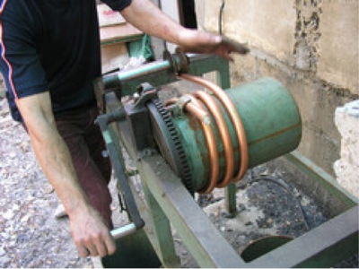

Step 6: ​6- the Condenser
A single long sheet is used to form the condensing recipient. The copper pipe that will become the serpentine coil is filled with sand and coiled around a rotating drum until it acquires the desired shape.

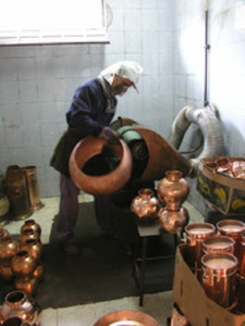

Step 7: ​7- Polishing
In the next phase the different parts of the still are buffed and polished by machine until they acquire a characteristic glow.

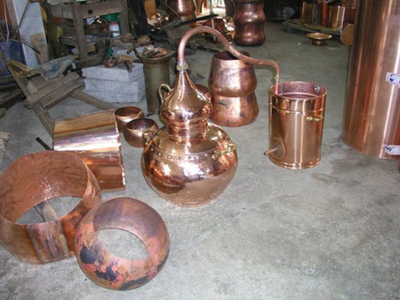

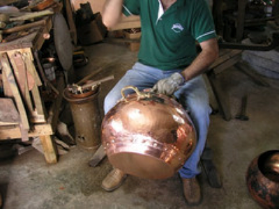

Step 8: ​8- Assembly
The different parts of the whiskey still are matched and joined together before being hand polished.

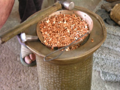

Step 9: ​9- Riveted Unions
The 3 parts that make up the alembic pot are joined together by means of rivets, small copper pins with heads on one end that are inserted through aligned holes at regular intervals along 2 overlapping joints, the plain end is then hammered to form a second head. A linseed oil paste is applied on the interior seam of this joint for a watertight union. This paste is inert and will not affect the distillation process.

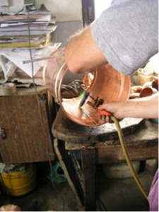

Step 10: 10- Soldering
The remaining parts of the whiskey still are soldered using either a tin or silver solder to form soldered unions. The solder used in our stills is guaranteed to be totally safe, harmless, and lead-free.
