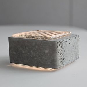

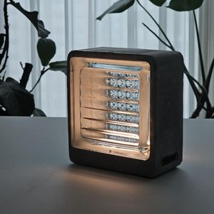

I'm showing you how I made the Glass Block Lamp using cement. You can make it by making a mold using PVC film and Foamex, and pouring cement dough into the mold. You can see a brief description of how to make the Glass Block Lamp here, or you can watch a video that shows how to make it in more detail. If you want a manual, you can click the link in the video information.
foamex(1mm), tape, PVC(0.3mm), USB LED light(100*40*10mm), glass block(115*115*80mm), instant adhesive, sandpaper, double-sided tape, mortar cement

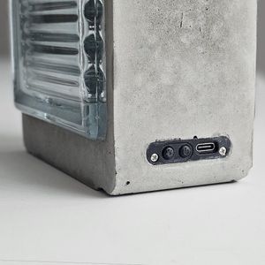

Step 4: Attaching the LED Module
Step 4. Attach the led module to the glass block. The button and USB terminal must be in contact with the side.

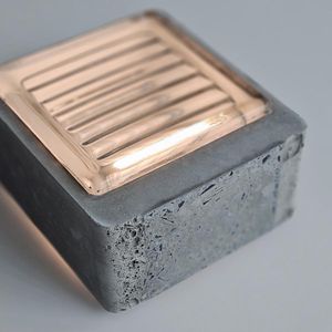

Step 6: Pouring Cement Dough
Step 6. Make the cement dough and pour it into the mold toward the bottom.
Step 7: Removing the Mold
Step 7. Once hardened, carefully remove the mold.
Step 8: Done!
Step 8. The Glass Block Lamp has been completed.
