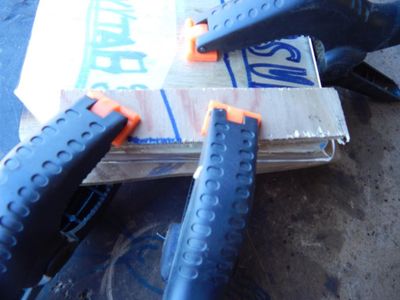

• Place your tablet on the plywood sheet and mark around it.
• Cut out the sheet to make a template the same dimensions as the tablet.
• Cut out the three extra strips of plywood to hold the hot folded edges of the perspex.
• I found the A4 sized sheet of perspex was exactly the right size for the Galaxy Tab. If you have a different tablet, cut the sheet to suit allowing about 30mm on each side and at the bottom for folding.
• Cut the bottom two corners off the perspex to allow for folding.
• Clamp the template to the perspex sheet with the top edge flush and equal overhang on each side.
• With the heat gun, carefully heat one edge of the perspex until it becomes soft and pliable.
• With gloves on your hands use one plywood strip to fold the edge of the perspex around the template and clamp it in place until it cools and hardens.
• Repeat this process for the remaining side ant the bottom edge.
• Mark the locations of buttons.
• Remover the template.
• Cut away any perspex that covers buttons.
• Test the size with the actual tablet. Mark and cut holes for the headphones and power sockets.
• If the size is not right you can simply reheat the perspex and it will return to its original shape.
