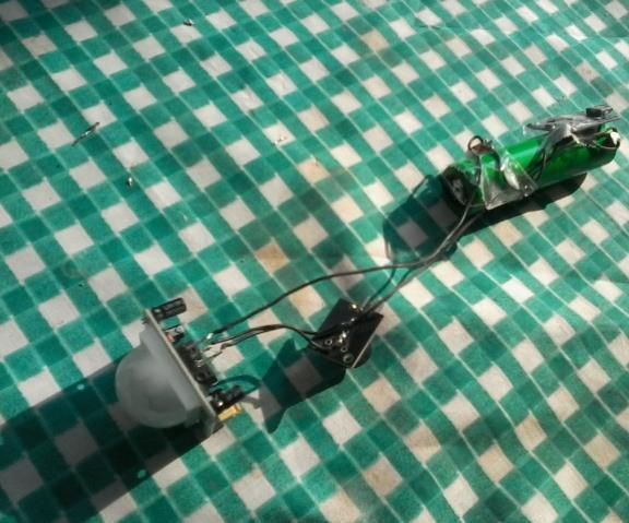

I glued two circuits together at the back of the base of the battery. If you are using a power bank circuitry then you will have to figure out for yourself a way to glue them.
Step 2: The Wiring
I first wired the batteries to the battery charger's B+ and B- pins. Then I wired the Out - of the charger to the In- of the booster. I put the switch between Out + of the charger and In + of the booster.
I am using a USB booster because the voltage of the battery is 3.7 v and phone's charge at 5v. So I boost the voltage to 5v using the booster.
