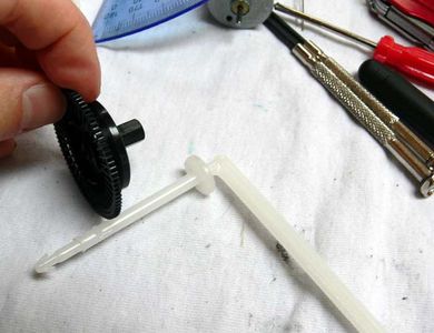

Step 4: Modify the Large Gear So It Fits on the Shaft
It is imperative that the large pinwheel gear spin freely and precisely. I had to drill a hole in the VCR play head gear I selected so that it would fit over the shaft of the pinwheel. After testing the gear, it was wobbling back and forth as it was spinning. In order to remedy this, I extracted another plastic cylindrical part from the VCR which fit firmly inside of the play head gear and on the shaft of the pinwheel. This reduced the wobbling of the large gear immensely. After I was certain that the addition of the new piece was a good idea, I reinforced it with epoxy.

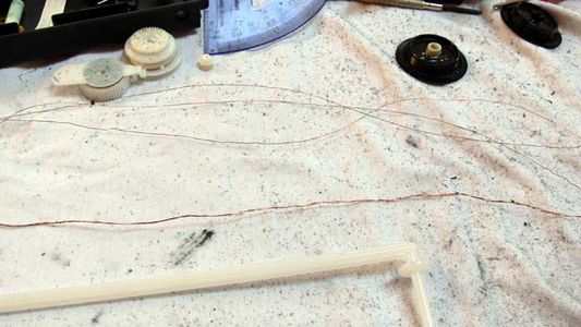

Step 5: Melt the Copper Wire Into the Pinwheel
You will now be melting wire for the motors positive and negative terminals into the shaft of the pinwheel. Take some thin copper wire strands and spin them together. I used three small strands that I had laying around and cut the final strand in half for the positive and negative terminals.
After you have the wire twisted into two larger strands, take your soldering iron and press the wire into the plastic of the shaft where the fan spins. Make sure to reference the video and pictures for the proper place to do this.
Do your best to try and melt the plastic in a uniform way so that the surface remains as smooth as possible. The fan will still have to spin over top of the spot that we are melting the wire into.

Now determine the best way to mount your main gear onto the pinwheel fan. I was lucky because the hole in the main gear was only slightly larger then the fan. I forced the fan over top of the main gear and it stayed in position long enough for testing. I reinforced the seal using epoxy toward the end of the project after I knew that I had the correct configuration.

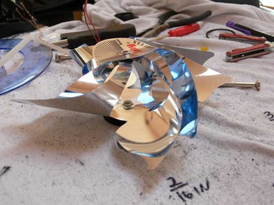

Once you believe you have the proper mesh, you will want to drill two more holes in the top of the pinwheel shaft by the location where you previously melted wires for the LED. This is in order to make holes for two screws which will be used to hold the main gear attached to the fan in place while the device is in operation. You can determine the best spot to make these holes by holding the fan gear in place and using a permanent marker to create spots on the top of the shaft for drilling.
