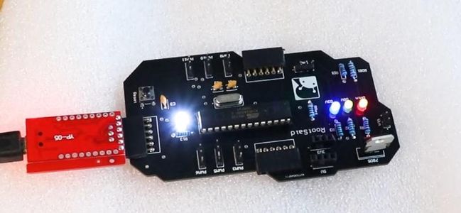

Also, I chose a white silkscreen instead of black. Perfect. On the next screen, we should be able to upload the Gerber file and submit it for review. Once the review is completed, all that is left is to add to the cart, make payment, and wait for the PCBs to arrive. Once the PCB arrives and you got all the components, start soldering. While soldering, make sure you check the polarity of the components and check the positioning of the IC. Once it is soldered, our Arduino Board looks like this!
Step 4: Testing
Now it’s time to upload the first code! To do that, connect the Arduino Board to the FTDI module and connect the FTDI module to the computer. Make sure you have installed the correct drivers for the FTDI module on the computer.
No fire up Arduino IDE and open the Blink example sketch. Now select the board – Arduino Uno and select the right port. Once that is done, click on upload. The code will be compiled and will be uploaded to the board via the FTDI module.
