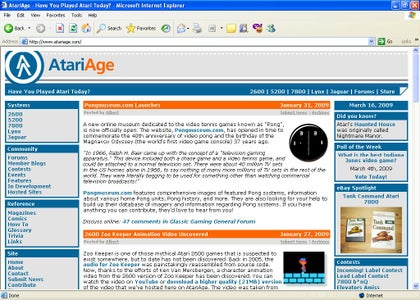

There are a few retro-gaming communities around the ole webosphere that you'll run across. The first one that I ran into, and the one that I consider the best is AtariAge http://www.atariage.com. You'll find all kinds of goodness there including game reviews, ROMs, high score clubs, a marketplace, and more including what we're looking for: information on programming for the VCS (and other retro game system coding).
The second community to mention is Digital Press http://www.digitpress.com. You will find a lot of information on old games here, but they don't just specialize in old games. You'll also run across information about all the newest consoles. I also joined this website in the midst of my Atari wanna-be programmer phase, but don't think it's quite as useful as the first.
The last community is a little unique in a few ways. The way I understand it, they don't have an "official" website, but have been hosted in several places. The Stella Mailing List http://www.biglist.com/lists/stella/ has searchable archives and I believe it dates back to the mid-90s. I don't think they still update the information, but in the past it would contain answers to fairly detailed questions from the community itself. You can still search through the archives and find a lot of the answers you need to difficult questions.
For the purposes of this instructable, I will pretty much reference the community from AtariAge. They also cross over to the other two sites, and vice versa, but AtariAge seems to be the most personable and the most helpful of the three for beginners (imho).

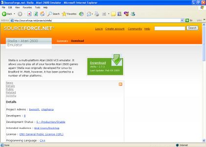

Next, is the emulator. Emulation of NES, SNES, Playstation and other systems has become a pretty big deal over the years, although the craze seems to have died down to some extent. Atari is no exception, and there are two emulators which seem to be worthy of the Atari programming community. The first is Z26 http://www.whimsey.com/z26/and Andrew suggests this is possibly the best solution for Windows users, yet he suggests using Stella http://sourceforge.net/projects/stella/ for users of other operating systems. I found z26 was able to perform all the tasks I asked of it, and can't recommend it enough.
