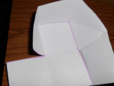

Step 4: Add a Cover to Diffuse the Light
Add a paper cover to the Arduino Board to blend the RGB values into a single, uniform color:
  1. Cut the paper into a square.
    The easiest way to do this is to fold the paper diagonally and cut off the excess (as shown).
  2. Fold the paper so that the creases divide the paper into nine equal squares.
  3. Cut four of the outside creases (as shown).
  4. Fold the paper into a cube with one open face.
  5. Tape the edges together.
  6. Place the paper cube over the Arduino.
    Optionally, cut a small hole for the USB cable to fit into.
  7. Turn on the Arduino by connecting it to the computer.
The paper cover will diffuse the light from the three LEDs so that the light is mixed together. The cube will now appear to smoothly transition through various colors.
