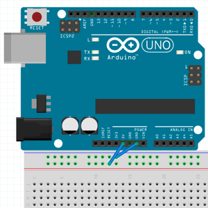

Step 3: Supplying Power
For this project, we can supply power to the Arduino through any +5V power source. You can use a USB port from your computer to power the Arduino, but in this project I will be using a portable battery. Before you connect a power source to your Arduino, make sure that the +5V port on the Arduino is connected to the +5V on the breadboard. Do the same and connect the GND port on the Arduino to the GND of the breadboard.
