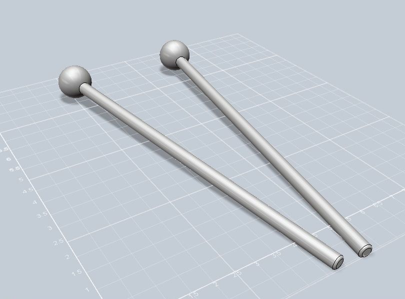

Step 1: Dowel Preparation
The dowels are going to be your mallet's handles (as you undoubtedly guessed), and will be the same for each mallet type. You want to be very comfortable with them.
- First off, decide how long you'd like your mallets to be, determined by what you use them on and how you like the length. I measured mine about 16 inches (yes, I know they are 18 in the picture, I cut them smaller later). Take a pencil and mark the point on the dowel that is the proper length. Do this for two, and make them the same of course.
- Take your small saw, and cut the dowels to the correct lengths that you marked on the dowels.
- For the best quality and comfort, sand the dowels so that they are nice and comfortable. Also sand the end tips that won't be the ends with the mallet heads on them.
