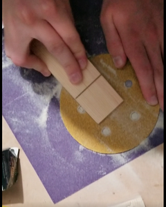

Step 2: Sanding the Car to a Flat Angle
Now, unless you are an amazing wood cutter and make perfect cuts in wood, your going to need to sand down some imperfections that you made while cutting. If you made some gauging cuts, start with 60 grit sandpaper, if you cut it pretty well, start at 100 grit and move your way up to 220, or higher if you so desire.
