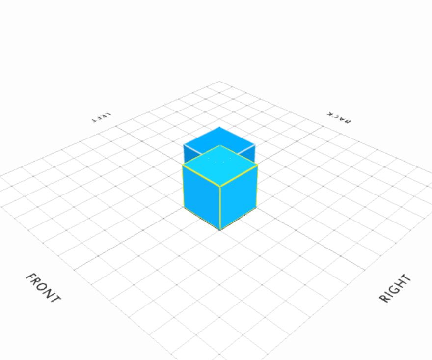

In the first drop-down list, you can set the horizontal position of the magnet, which means you can select which side or even edge of the figure will connect with another object.
As you can see, by selecting the horizontal origin on the Right, I set the point of connection at the edge of the cube.

I have here 2 copies of the same model, and as you can see, with selected Magnet option I can connect them at many different angles, simply by dragging my cursor around. In the beginning, I told you that simply changing the position and rotation will only suffice while working with shapes that don't require complicated measurements. Just imagine how long it would it take to figure out just the angle of rotation, so you could merge these 2 figures perfectly. With this tool, you don't have to!
