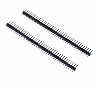

8. Male pin header

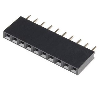

9. Female pin header
