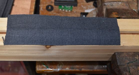

Step 4: Gluing the Signatures Together
Steps:
1. First you need a way to hold all of the signatures together. The easiest way is to use a couple of pieces of wood and a vice. You could also just use a couple of clamps and some wood as well.
2. Line-up all of the signatures so the spines are even. Before you glue, make sure that all of the signatures are in the right position – you don’t want to have any upside-down or the pages in the wrong sequence.
3. Clamp together. There should be about 5-10mm of the spines sticking-up.
4. Add some glue. The glue should be acid free, ph balanced and flexible. Any store that sells scrapbook material will have this type of glue. The glue needs to cover all of the spine but not too thick as you don’t want it to run.
5. Next cut a piece of the material. It should be as long as the book and about 60mm wide. Add some glue to the middle of this and attach to the spine.
6. Press lightly along the spine and make sure that the fabric is touching all parts of the spine.
7. Leave to dry for 24 hours.
TIP - Don't over-do it with the glue - you don't want it to drip down the page and onto the wood that is bracing the signatures together. Just make sure that you have glue covering all of the stitching.
