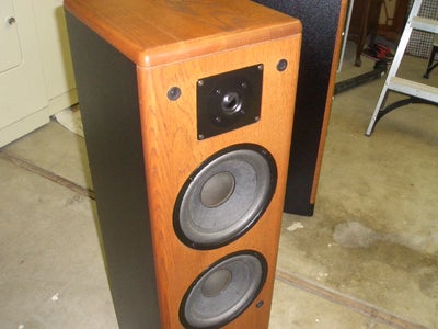

Obviously you will need an old pair of speakers. The foam surround kits are not inexpensive so make sure you are getting a decent pair of speakers to begin with. Also the paper cones should move freely and they should still make sound when played. All the drivers should play. If they have been energized a lot with the surrounds damaged, the voice coil could be abraided away, shorted out, etc. Those should be avoided because I don't think that's an easy fix. Today we are working on a pair of Advent Heritage speakers. They are not the classic Advents and were produced after Jensen bought the company and ruined it. However these speakers, despite, their shortfalls, sound really good to my ears. The cabinets are pecan and clean up really well.

Take all the drivers out and make sure the leads are all in place. Don't confuse where they go or you will have the crossovers driving the wrong driver when you put them back together.

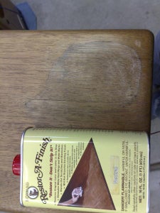

While the drivers are out, give the cabinets a good cleaning. Howard's Restore-a-Finish is pretty good stuff. It doesn't have much color to it but it does have some. It can really make scratches less noticeable.

Most speakers are made with mdf. On top of the mdf you may find veneer if you are lucky. If you find sticky paper, you probably shouldn't bother doing this procedure at all anyway.
I clean them up nicely; maybe use a brown maker or stain marker to touch up the scratches. Use a finish restorer or just furniture polish off the shelf. You'd be surprised how nice they can look with just a good scrubbing with a rag and some off the shelf lemon or orange oil furniture spray.
I took the cloth speaker covers out to the back yard and sprayed them with 409 and the hose to get twenty years worth of nicotine out of them. The color fast synthetic material looked great when I was done. Use your head if your panels are not synthetic, woolite and a damp rag may be better. However, the synthetics were cheaper so that's mostly what I've found.

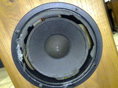

To remove the old gaskets, just use your finger to pick off as much as you can.
Then use your toothbrush or stiff nylon brush to remove as much of the old material as possible. Don't bother trying to remove the glue. Also if your drivers are even half way decent, they will be really tough. Don't worry about ruining them. However try not to damage the voice coil by dragging the cone up and down in the basket while you are doing all this.
In the picture below you can plainly see that there is a plastic beauty ring covering the part of the gasket or speaker edging foam where it attaches to the basket. This has to be removed. I couldn't figure it out at first but the supplier whom I purchased them from emailed me back the same day to explain the problem and give me a solution to it. I used a hair dryer to soften the glue then gently pried the rings off with screwdrivers. Worked like a charm.
