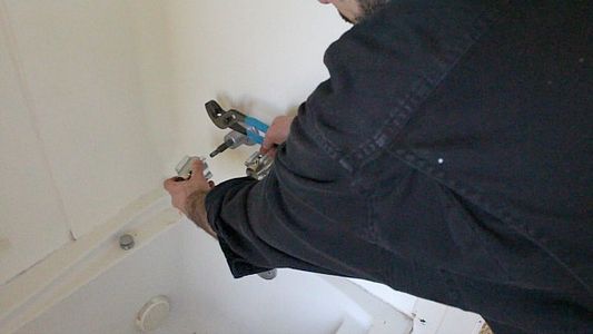

Step 5: Remove Shower Head
If you’re reusing the shower head here’s a tip.
Place a rag over it. Use your channel locks to loosen it from the shower arm. This prevents the channel locks from scratching the shower head finish.
Step 6: Disassemble Shower Handles
Our shower had an old school 3 handle setup.
If your shower looks the same remove the screw from the handle.
Pull the handle and escutcheon off the shower stem.
I had to, ahem, coax the handle off the stem with my channel locks.
The last picture shows the escutcheon.
Step 7: Remove Shower Stems
Remove the stems from the shower plumbing by turning them counterclockwise.
This is where channel locks come in handy, love LOVE these to death.
Step 8: Remove Tub Spout
Check the tub spout for a set screw.
If you have one, loosen it with an allen wrench. Turn the tub spout counterclockwise or simply pull it off the copper.
