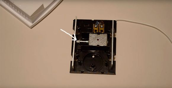

Step 6: Check the Chime
Remove the chime cover plate and tighten any wires that appear loose. Check the wires with a voltage tester while someone else pushes the bell switch.
If it is getting power, but not ringing, you need to replace the chime in the same manner as described for a transformer. If power is leaving the bell switch, but not reaching the chime, you have problems with the actually wiring.
You could replace the wiring if it is easily accessed, but it most often won't be. Your best bet is to replace your existing bell with a remote bell that doesn't require wiring.
