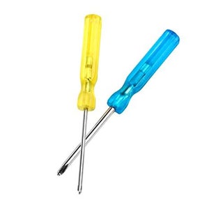

Step 1: Tools You Require
  1. 4 wings screwdriver

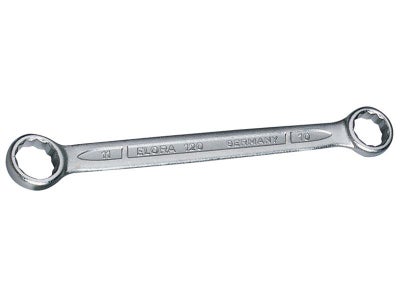

  2. 7mm ring spanner
  3. 10mm ring spanner
Step 2: Opening the Body (front Guard)
The two black pads in front of the body contain two screws each hidden behind the pads that are needed to be removed.
For that use, 4 wings screwdriver.
Then from the dashboard side below the headlight, there are two screws, and remove them too.

Step 4: Removing Old Battery
First, remove the center clamp that is holding the battery tight to its case.
For this, you need to use a 10mm Ring Spanner( "10" number written on it).
Second, Use a 7mm ring spanner or the screwdriver to remove the nut-bolt or screw that is holding the battery connector wires to the battery terminals.

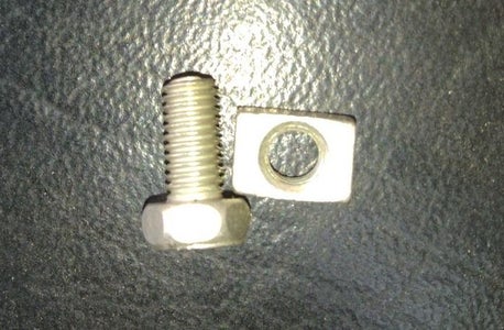

Step 7: Inserting the Battery
You will get two new pairs of nuts and bolts with the new battery to connect the terminal to the wires.
Insert the nut below the given battery terminal(on both sides) as shown in the image above.
Now connect the wires with the battery terminal and use the given bolt to tighten it. Use the same Ring Spanner which was previously mentioned in steps.
