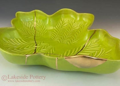

This tutorial is an example of one of the methods we use to sculpt and add a missing pottery rim segment using the resin casting technique. The finish can be seamless repair or Kintsugi repair.
See more Kintsugi examples or more of before and after seamless repair examples

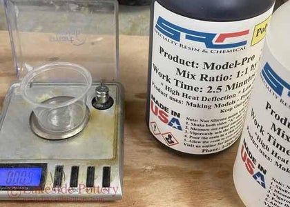

  5. Two parts epoxy resin
  6. Scale

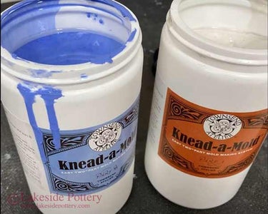

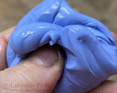

Step 1: Mix Casting Mold
Mix well two even parts of casting mold

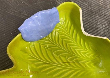

Step 2: Apply Casting Mold
  1. Apply casting mold to an unbroken segment

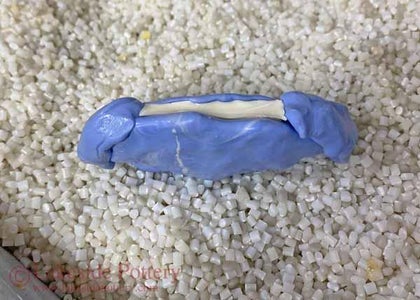

  2. When shaped casting mold cured, add more casting mold on the side opening

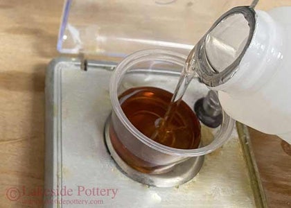

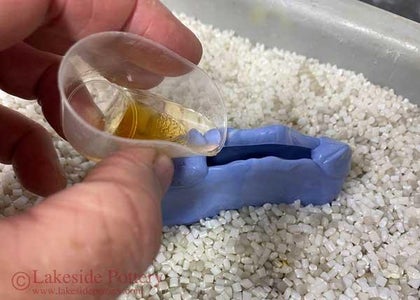

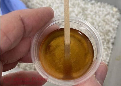

Step 3: Preparing and Pouring the Resin Epoxy
  1. Pour equal parts of resin-epoxy
  2. Mix the two part resin epoxy well
  3. Fill the mold impression with casting-resin

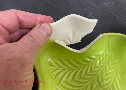

Step 4: Resin Epoxy Curation
  1. Wait for casting-resin to cure
  2. Remove newly made segment when cured
  3. Segment ready to be applied

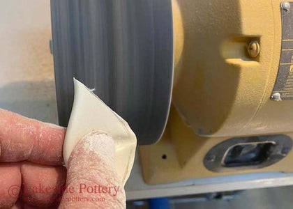

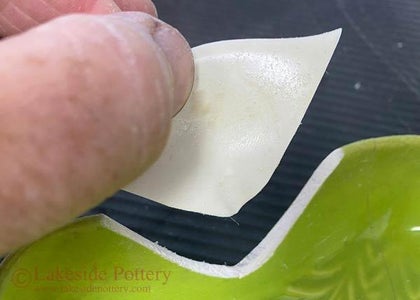

Step 6: Shape to Size
  1. Cut close to the penciled line
  2. Grind for final sizing
  3. Verify proper fit

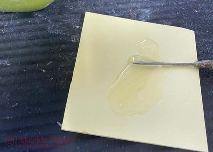

Step 7: Mending
  1. Mix two parts epoxy
  2. Apply epoxy
  3. Place segment

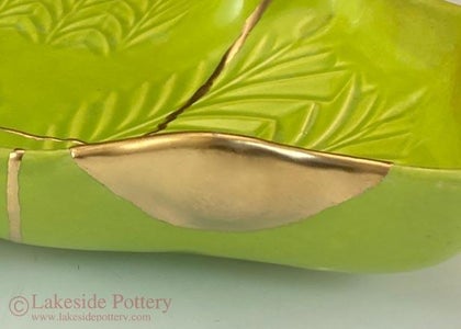

Step 8: Added Segment Ready for the Next Steps
  1. Segment applied and ready for a filler application
  2. Follow to filling instructions in our web lessons (see link below)
  3. Apply the Kintsugi process or a seamless repair (see link below)
