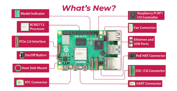

Compared to previous models, the Pi 5 version brings significant improvements, which makes it more capable of handling AI and ML tasks:
More Power – A quad-core Cortex-A76 processor at 2.4GHz gives it a serious performance boost.
More RAM – Being available in 4 and 8 GB RAM, the Pi 5 allows for better model execution.
PCIe Support – Allows faster storage and even AI accelerators for better computing.
Improved GPU The VideoCore VII GPU helps with image processing and light ML workloads.
Lower Cost – Just a fraction of the price of traditional AI hardware.
