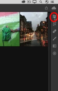

Step 1:
First, with a photo selected, click the Edit icon on the right to access the panels of editing controls.
