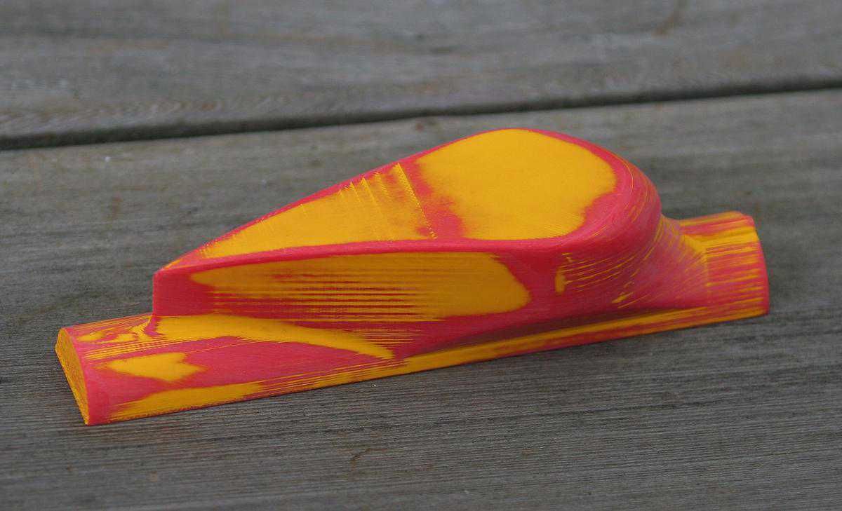

Step 2: The Jolly 3D Printing Torture-test
To show you how the different methods work I decided to go with everybody's favourite torture test: 3DBenchy.
It was printed at a layer height of 0.2 mm (I usually go with 0.15 or 0.2 mm for big parts). Since it is a rather small part I would usually go with solvent smoothing, but decided to show you every process with the same model. All 3DBenchys were printed with my Ultimaker 2+ extended and I used Simplify3D as a slicer.
I have also included some images of fails I had in the past, so that you can hopefully learn from them.

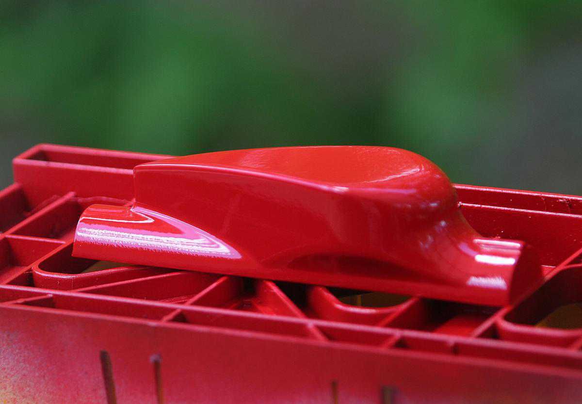

To see whether the Deadpool Knife Block was really smooth I decided to spray paint a layer of primer onto it. After seeing that it wasn't I applied another layer of epoxy and the result was horrible. As you can see in the image on the right, the epoxy formed a really weird, absolutely not smooth surface. So never apply another layer of epoxy to a spray painted surface unless you are very sure it will work.
