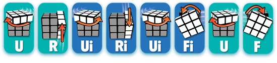

EACH SIDE OF THE CUBE IS REPRESENTED BY A LETTER
R = Right face - Right side of the cube
L = Left face - Left side of the cube
U = Up face - Top side of the cube
D = Down face - Bottom side of the cube
F = Front face - front side of the cube
B = Back face - Back side of the cube
The letter with an “i” after it means an inverted or counter-clockwise move when looking at that face directly
VERY IMPORTANT
When making the moves above hold your Rubik’s Cube full-face front with the logo on top as shown. Dark grey on the pictures means that the color does not matter. Each move is a 1/4 turn rotation.
