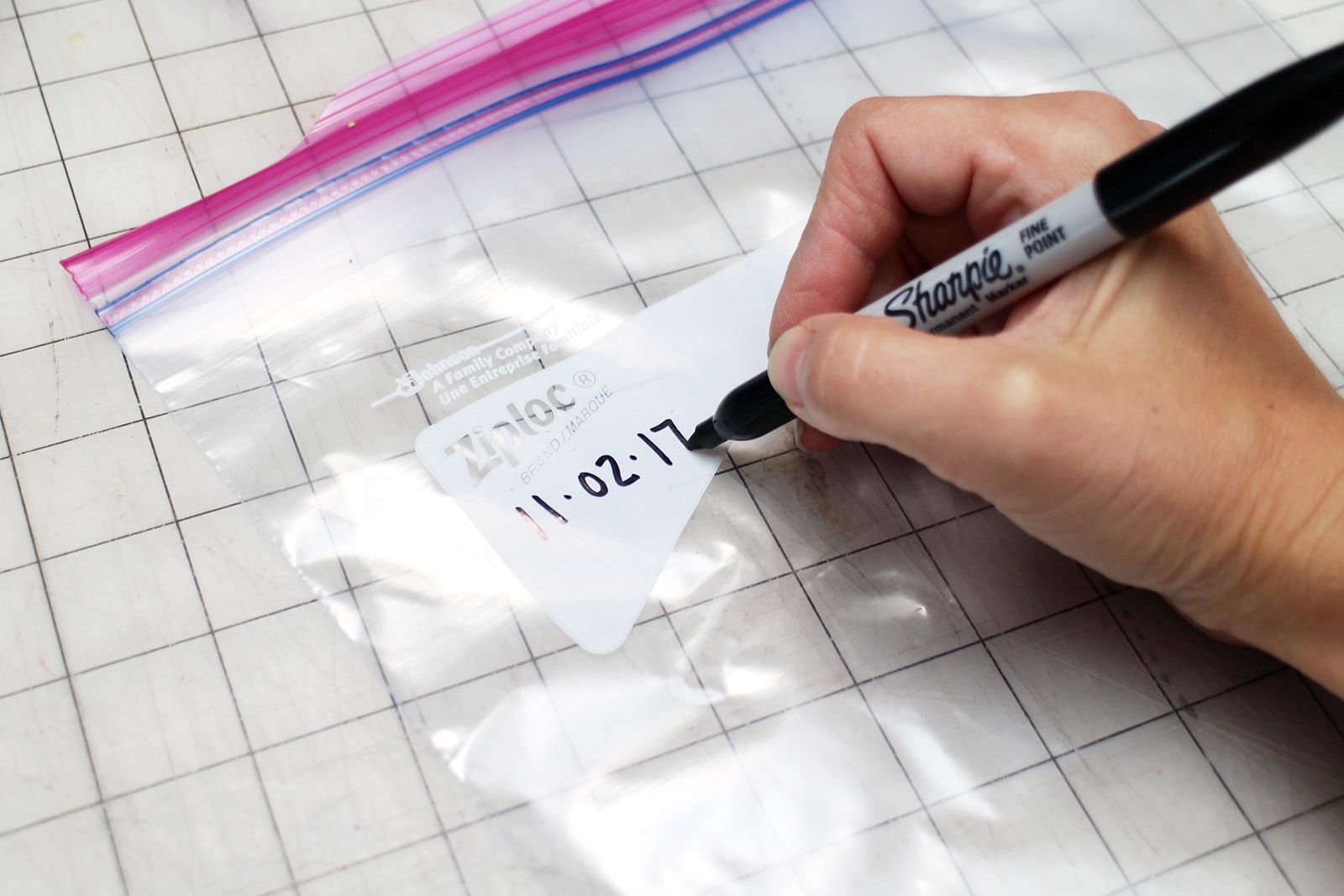

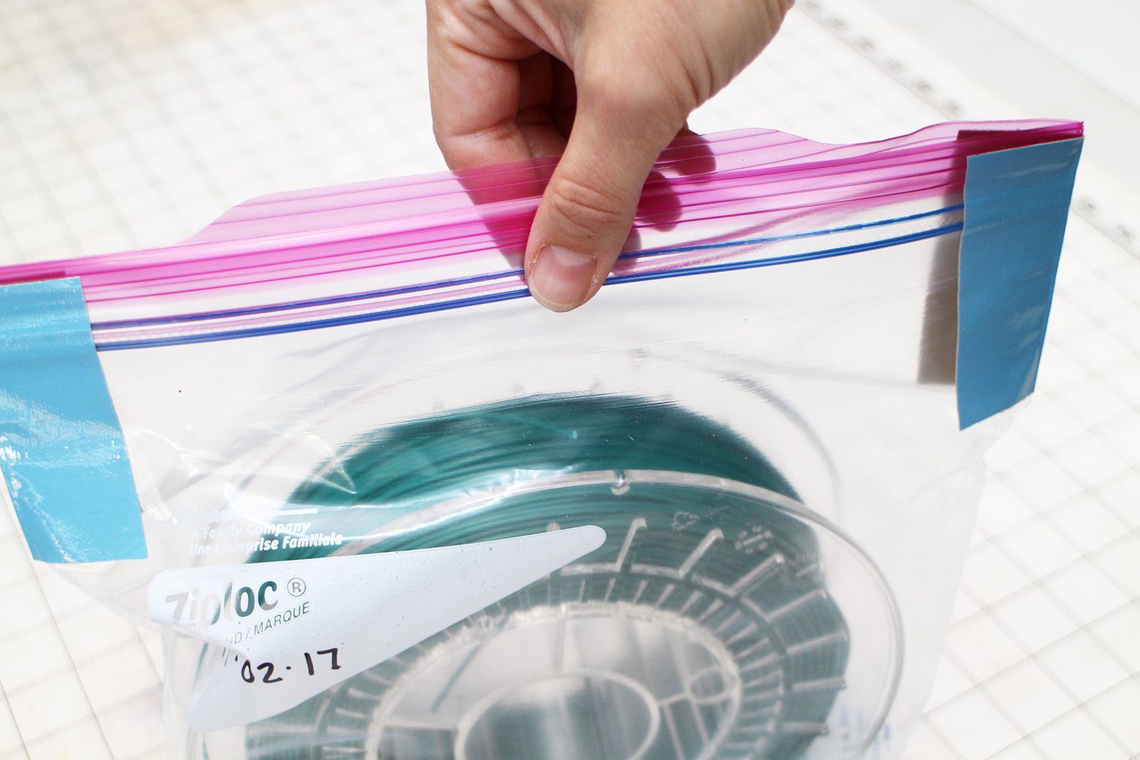

Step 3: Date the Roll & Bag
The rule of 'lifespan' thumb for a roll of PLA or ABS filament is 12 months (check with the manufacturer for other types). This is why I like to mark my rolls with the calendar date it came in the mail. *You can also date its storage bag if you'd like.*
It's safe to assume that at least 1 month (maybe 2) has passed since the roll was manufactured – due to transport and storage times as it changed hands from manufacturer to fulfillment house to you, so I usually try to finish each roll within 10 months of those written dates.

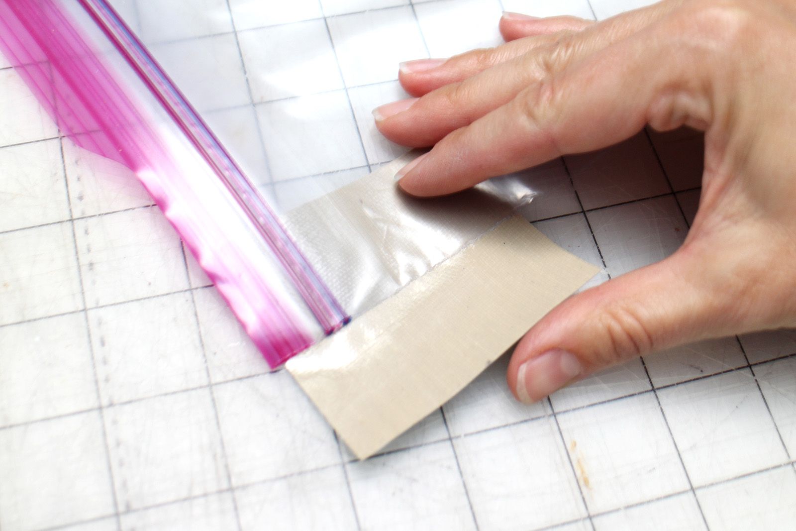

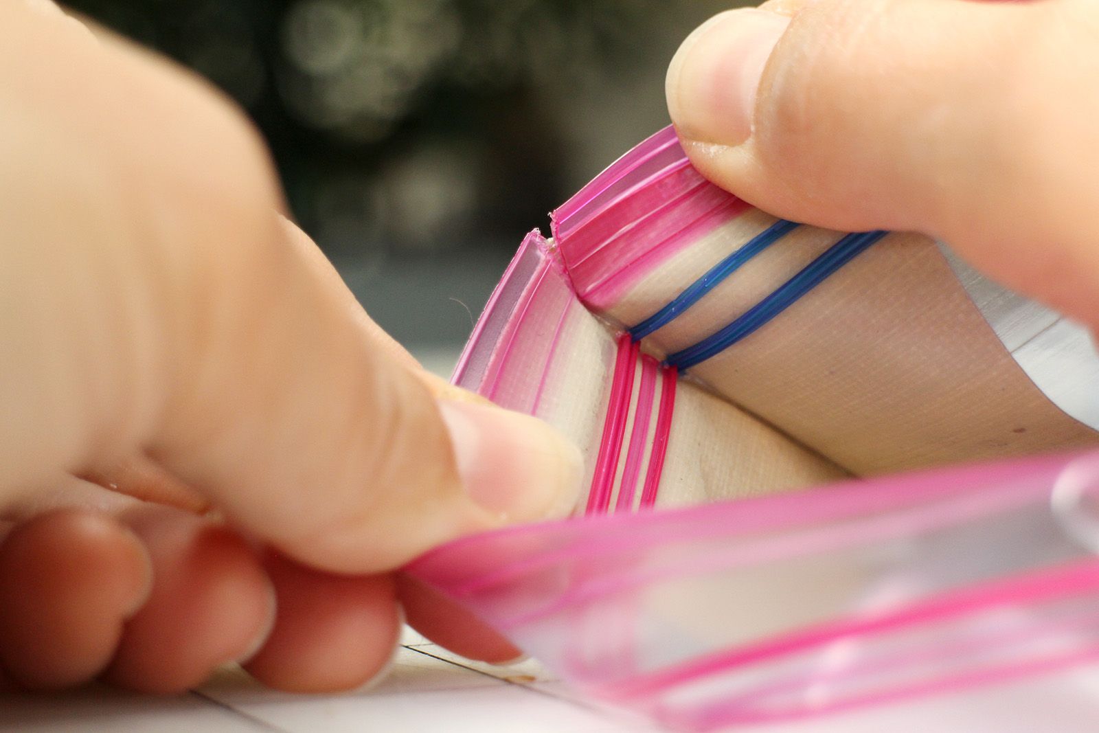

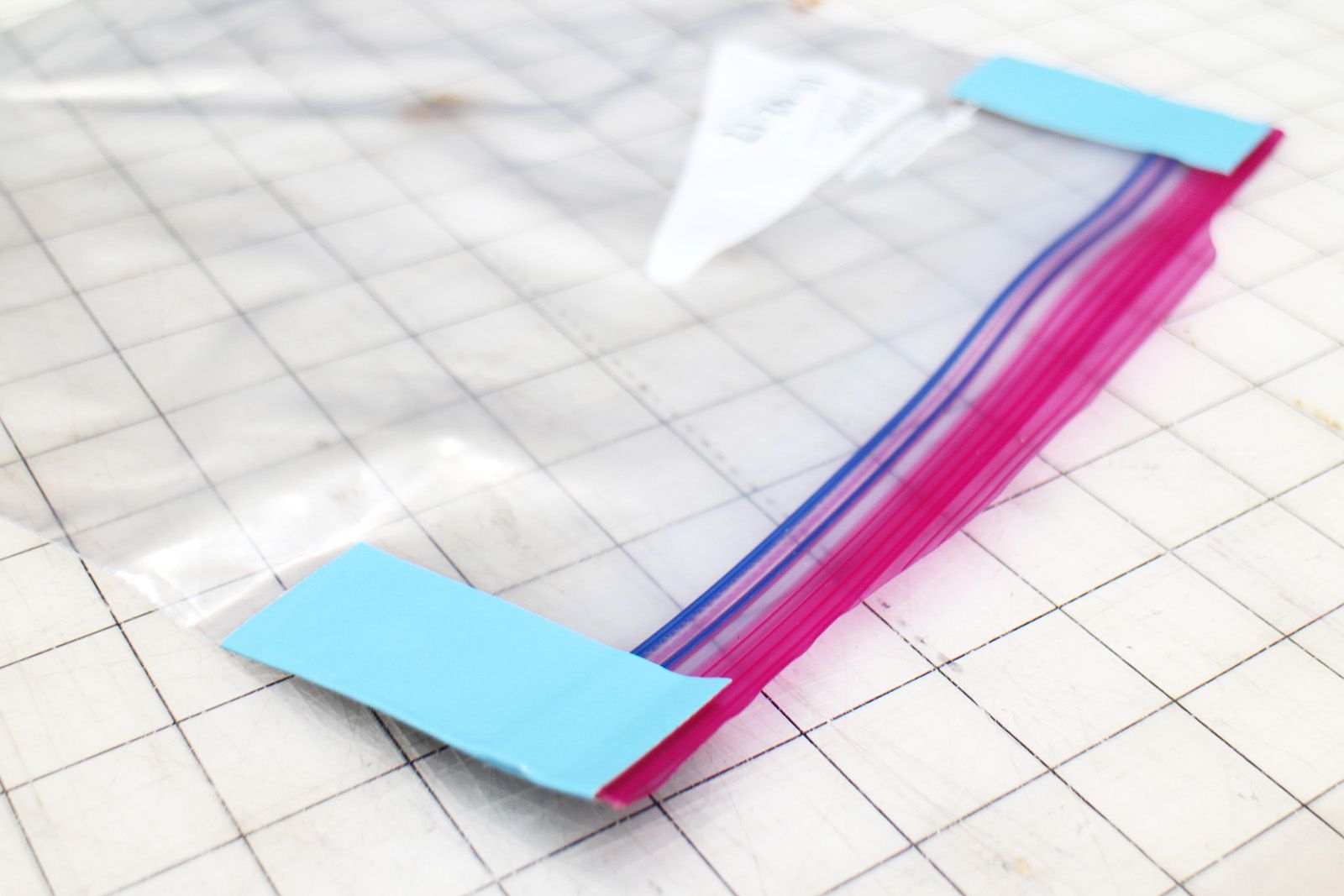

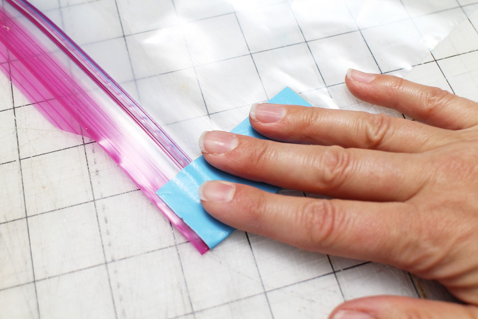

Step 4: Reinforce the Bags
- Cut two 3" pieces of duct tape.
- Stick one (in half) to each top side of a one gallon plastic storage bag. (like pictured above)
This is important to do because the sides of the bags can easily split over time as you take the filament roll in and out. This reinforces those weak points and gives the bag a very long life.
Ta da!

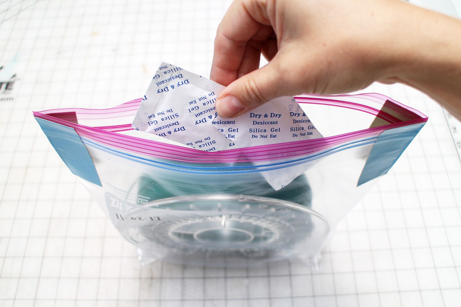

Step 5: Load the Bags
- Next, load a roll of filament into the bag.
- Add two silica gel packs to the bag.
- Seal the bag, making sure that it's properly closed the entire way.
TIP: Stop an inch short of sealing it and press out as much air as you can before sealing it all the way!

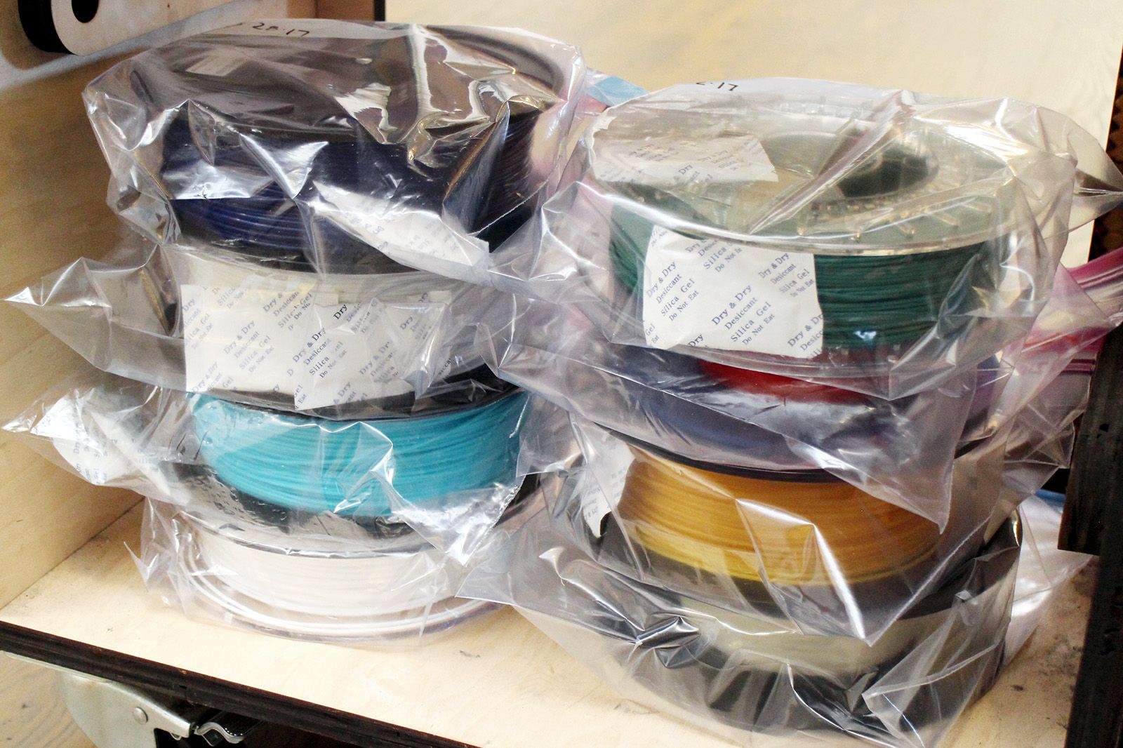

The only thing left to do is to stack your safely stored rolls in their designated home!
NOTE: If you're trying to make tall stacks, the bags can make this hard due to their 'slip and slide'iness. An easy fix for this is to place a 1/2 or 1/4 sheet of regular printer paper in between each bagged roll. Slip problem solved!
And that's it! Like I said, it's a VERY simple solution to a potentially expensive problem.
