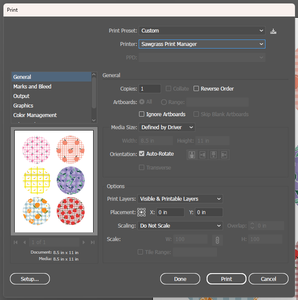

Step 6: Navigate to File - "Print" and Select "Sawgrass Print Manager" As the Printer

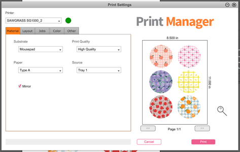

Step 7: In the Printer Manager, Mirror the Pattern and Select "mousepad" As the Substrate
