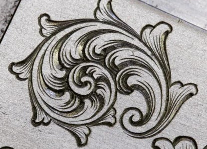

Download Creality Workshop - "CW" - from here - I promise it's legit. Download a JPEG image of your choosing that has clear outlines - like a flower. Open CW up and select Import. Import your downloaded JPEG, like in the picture.
Select Laser and Outline at the top. Resize it into the size of your engraving material, minus about 3 mm. You can refer to the pictures for what to click on/edit to resize easily. Click on "settings name" and use these settings:
- Laser On Cmd - M106 S255
- Laser Off Cmd - M107
- CNC On Cmd - M106 S255
- CNC Off Cmd - M107
- CNC Travel Z - 50-80 - higher is more focused and lines are thinner. If you want thick lines, smaller numbers are better
- CNC Print Z - Same as before - it's best not to be different
- Travel Speed - 30-60 - This one's the speed of the laser when it's not engraving
- Laser/CNC speed - 1-3 - very important - too fast makes it not engrave, too slow makes the lines burnt
These are just the settings that worked for me, after about 6 hours of trial and error.
Click Export GCODE and move the file to a MicroSD card. Eject it and stick it into the 3D Printer. Make sure that you have followed all the steps for prep in the previous step first. Select the file, and start the engraving!
